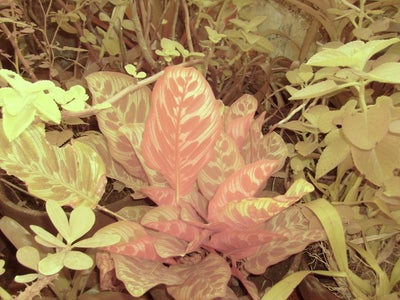

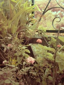

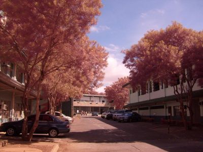

Step 3: Sample Output
Enjoy these sample output off my newly modified Samsung S630. Also, after the modification, your camera would be able to detect IR now that the cut-off filter has been removed. I was able to test it using a my TV remote and the digicam was able to detect the lovely purple light. See above picture...
