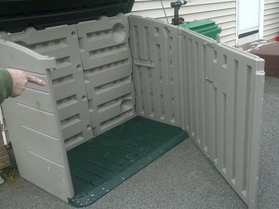

Step 3: Open the Door
Once the door is reenforced, you now want to separate the door from the side panel. One, this makes it easier for the person inside to get out without resorting to using a ladder or milk crate. Two, this will make the next step easier.
Keep in mind that one side panel has the lid support rod. It is best to work with the opposite side. This allows you to still use the lid support rod with the modifications and gives you the greatest versatility. There are two possible methods to getting the door open. By using some force to separate the door from the side panel or by cutting the hinge pin.
By Force:
It is easy enough to separate the door from the side panel with brute force. A long screwdriver and some pressure is enough to do the trick. Insert the screwdriver where the hinge pin is located. (See photo) This is the horizontal gap where the side panel and door overlap. Use the screwdriver as a lever to separate the door from the side panel. This method proved easy enough in practice. A little patience and trial and error go a long way here.
By Cutting the Pin:
In the next step you will be making a number of cuts to ensure the side panel open and closes smoothly. While we did not have to resort to this method, there should be enough play to allow you to cut the pin now. In this case be careful not to cause additional damage.
Photos: 1) Shed with door and lid open. 2) Side panel with the door removed showing the hinge pin.

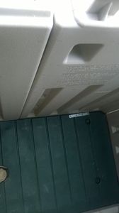

Step 4: Adjusting the Clearance
Once the door is free from the side panel there are a number of cuts/modifications so the side panel opens and closes freely. Many of these cuts can be made with the shed assembled; however, disassembling the shed first may make them easier. On the floor are four cuts/grinds that can only be done when the shed is disassembled.
1) The Hinge Pin
If you have not cut this in the last step, this is now the time to do it. You want to cut the pin off as flush as possible. The reciprocating saw worked well here.
2) The Bottom Pivot Point
On the bottom of the door is a small bump that rest in a corresponding indentation in the floor to keep the door from slipping. Since the door no longer hinges here, this bump can be removed to allow free movement. The reciprocating saw worked well here. Cut flush.
3) The Floor Stop
On the floor of the shed where the door hinged is a a stop/bump. While you do not need to cut this for the side panel to act as a door it does cause the side to stick. Removal allows the side to open and close freely. The reciprocating saw worked here. The photo here shows more cut that is necessary for this step.
4) The Floor Locking Tabs
The floor connects with the side panel via a rail with four protruding tabs. see photos. To allow the door open and close these tabs need to be cut flush with the rail so the tabs are no longer holding the side panel to the floor. See photos. In this case a picture speaks a thousand words. Utilize them to help your understanding. These cuts are best achieved with the shed disassembled. Make the cut by using a rotary cutting tool (Dremel) with a cutting wheel to trim the tabs down. Switch to a grinding attachment if necessary to get things flush. Repeat on all four tabs.
Photos: 1) Side panel with door removed/visual of the hinge pin. 2) Bottom of door where bottom pivot (removed) would be. 3) Floor where the door panels pivot. 4) Photo of the door stop removed. 5) Side panel showing where the panel meets the floor. 6) Side view of the floor before any cuts are made. 7&8) View of the floor with the tabs removed.
