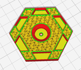

The tiles should be printed face down. If your printing bed has a nice surface you wont need any adhesion structure, if not a raft will help you achieve a homogeneous look. The parts are deigned to be printed with 0.4 line width and you will have issues if you use bigger ones, but it doesn't contain any fine details and it will print well using 0.3 or more layer height.

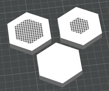

Following the feedback from some users i added 3 new type of tiles for designs with 2 pins. Two of those tiles have a mesh pattern so you can push your pins anywhere in the tile center. Choose the "big mesh" or "small mesh" version depending on the spacing between your pins.
The 3rd "tile to pierce" has a flat surface and you need to use a small drill to piece holes at the most convenient position for you.
