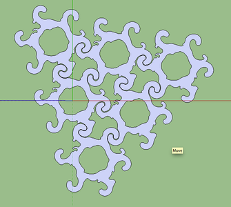

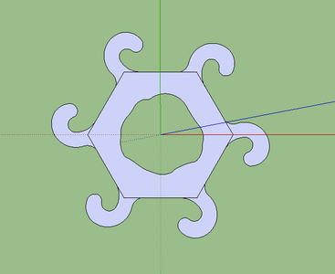

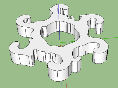

As my first 3D printing design, I worked in SketchUp, which is a free program that is a great starting point. My goal was to create a modular form that could be replicated and interconnect. I was thinking about vertebrae and came up with a hexagonal shape with interlocking paws, somewhat inspired by barrel of monkeys. I started with a hexagon, added curved shapes on each corner, and then modified the lines to give it a more organic feel.
Step 2: Print
I tested to see if the arms would interlock when multiplied, making sure to leave a bit of extra space. The organic polygon was then extruded in SketchUp and finally 3D printed. I estimated the depth of extrusion because I wanted the forms to be able to snugly interlock and have the potential to stand vertically, creating a sort of 3 dimensional textile.

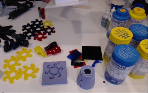

This type of mold is called a Dump Mold, and it was created using Smooth-On's Oomoo30. The 3D printed shape was hot glued to a piece of foamcore and then shallow foamcore walls were hot glued to the base. This creates a leak-proof box to pour the Oomoo rubber into. Once the two Oomoo components are mixed together, the rubber is poured into the foamcore box above the height of the 3D printed object. The rubber will set in seven hours. Any rubber that has crept under the form can be trimmed back with a sharp blade.
Step 4: Multiply
To make multiples, the mold was filled with SmoothCast325, which is dyeable. Like the rubber, this comes in two parts that are mixed together to start a chemical reaction. Dye may be added to add color to the resin. Once the resin is ready, it is poured into the rubber mold. The cast resin can be popped out while it is partially set (still malleable) and allowed to fully set outside the mold while a new form is cast.
Step 5: Interlock
Once the pieces were set, they interlocked beautifully! I'm still experimenting with the amount of dye and hanging them vertically. Backlit translucence creates a cool effect.
