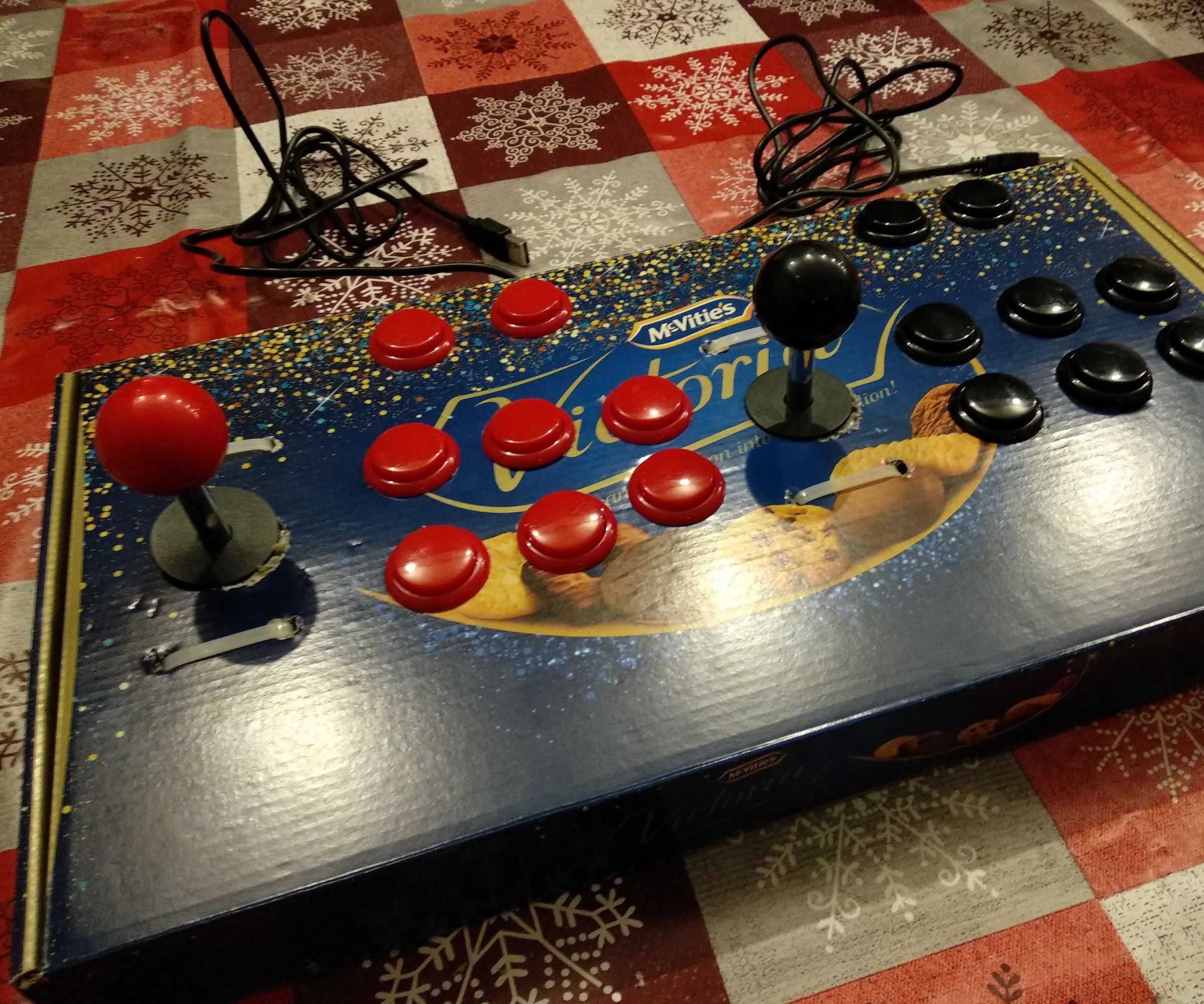

Step 5: Control Module Wiring
Again, I recommend considering a plug and play kit instead of the approach documented here. Only follow this approach if you:
A. Want full control of the low level button handling code
B. Really enjoy soldering and custom wiring (who doesn't)
C. Already have the tools and parts and/or want to save a few bucks
D. Want to learn more about this stuff or just practice
My personal motivations were a mix of the above. Ok, so here's how I did the wiring:
First I made adapter cables to join the crimp connectors on the buttons to the Dupont connector wires. I made one of these for the micro-switch in each of the buttons and the four in each of the joysticks. Shout out to outlaw Larry for a dig out on the production line for these.
I then used these custom cables to connect the buttons and joysticks to input pins on each of the micro-controllers via the breadboards.
NB: In this design there is a separate micro-controller and hence USB cable for each player. Divide the joystick and button micro-switches accordingly between them and wire both the pinball buttons to the same micro-controller. Check out the photos which show a progression through the wiring stages if you get stuck.
Next I needed to add a wire to send a signal to each of the micro-switches which would then return the signal to the micro-controller input pin when the button was pressed. I used the 4 twisted pairs in some some Cat 5e cable to provide the signal to the joysticks by soldering them all together at one end and attaching a Dupont connector cable connected to the signal pin on the micro-controller.
I made a little daisy-chain cable for each of the 6 button clusters and finally used my custom adapter cables on the start/select and pinball buttons again all wired to the micro-controller signal pin.
Wiring the micro-switches to the micro-controllers was pretty straightforward due to the use of the mini-breadboard and Dupont connectors which meant I could easily move the wires around as necessary.
Step 6: Controller Code
The code is pretty basic. I modified a gamepad example from the excellent Arduino Joystick Library
You can learn more about getting started with that library from this handy instructable.
At the end of this step we had a functioning 2 player fight-stick controller so we celebrated with a few rounds of StreetFighter2 on my laptop!
I originally planned to connect the micro-controllers directly to the Raspberry PI via USB but while testing on the laptop I found that connecting and disconnect the micro USB connectors to the micro-controllers via the access panel was very fiddly and I eventually broke off the micro USB connector from one of the micro-controllers.
The solution to this was to include a USB hub in the control module. This meant that only a single connection was exposed form the Control Module and the overall solution was much more robust. With the wiring complete I added countersunk screw holes to the top panel and screwed it in place.
