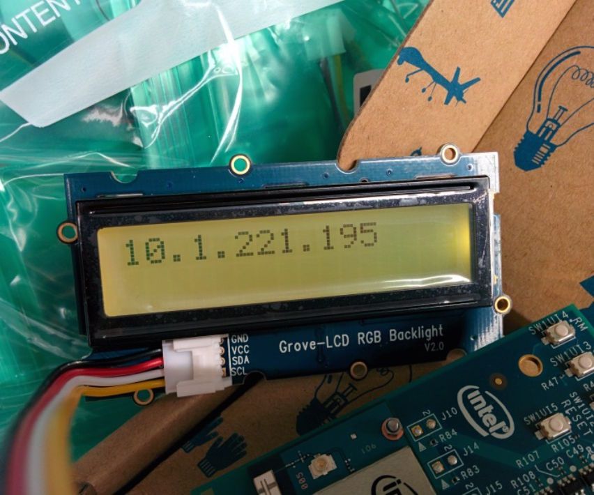

Step 1: First Things First
Connect the Grove LCD Module to the Edison development board.
Get the IP address of the Edison development board using: https://www.instructables.com/id/Show-the-Intel-Edi...
