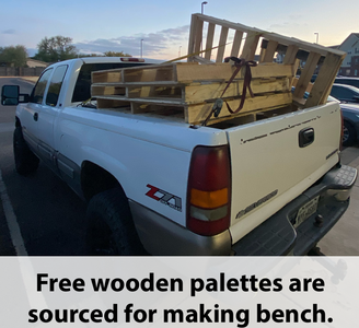

  1. Wooden palettes (free off of Facebook Marketplace)

I cut up the salvaged wooden palettes into 4 equal pieces, then chamfered the corners to form the central aperture. The sheet wood was used to patch the holes where the palette boards didn't cover. The PVC pipe was incorporated as a dowel joint on the underside of the modular pieces (with aligned hole slots on the top side).
