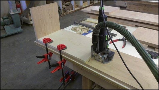

Accurate placement of the mortises on the horizontal shelves is best achieved with a series of spacers. These spacers are made from plywood cut to the width of the individual shelf openings. NOTE: Make sure the spacers are cut square. If they are not square, the unit will not fit together properly.
Since this wall unit is composed of three modular units, the spacing of the vertical dividers will be different. Individual spacers will have to be made for each different vertical divider position.
The spacers are marked with the exact positioning of the mortises in the vertical dividers. The Festool Domino joiner is used in a vertical position to cut the mortises. These mortises are made on the face of the horizontal shelves. NOTE: The depth of these mortises should be at least ½” deep and no more than ¾” deep.
The end vertical dividers are inset ½” from the ends as shown in the inset photo. NOTE: The mortises for the end vertical dividers of each module are inset an additional ½”.

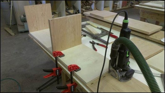

Attach the end vertical board as the reference point on the horizontal shelf.
The first spacer is clamped to the horizontal shelf and the mortises are then cut. Make sure the spacer is butted tight to the vertical divider.
After the first set of mortises is cut, the next vertical divider is positioned as is the next spacer in order to cut the next set of mortises. Continue this process until all the mortises are cut into the horizontal shelves.

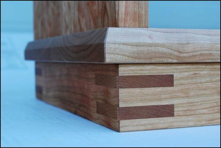

The bases are made from 2 ½” wide, 1” thick cherry hardwood.
Both bases are 1” shorter and narrower than the horizontal shelves. This provides a ½” inset on all sides.
The corner construction consists of mitered joints reinforced with splines. There is also a cross brace in the middle of the long base. The cross base is connected in the same manner as the base frame to the bottom of the long self.
