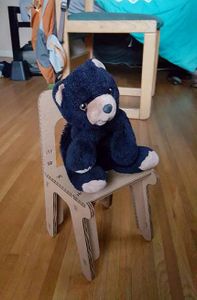

Introduction: Modular ChaiR
This modular chaiR is a WIP project constructed using Autodesk Fusion 360.
The idea behind the project stemmed from the constraints that a college dorm room usually puts on the student: there is always not enough space.
This chaiR wishes to tackle this problem by allowing the student to first customize the chair to his ergonomics and then to the modify the chair with some simple tools integrated into the program via a plug-in. The student can then export the files to be laser cut for the fabrication of the chair.
This tutorial will go through the installation of the program necessary to modify the chair, an explanation of how to change the parameters to fit a person's body type, an explanation of how to add the modules and finally a tutorial on how to export the files to laser cut.
