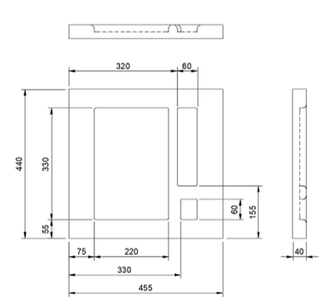

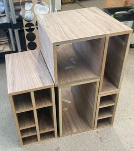

Step 1: Mark Out and Cut Panels From MDF Board
Mark out the measurements for each module as seen above. The number under "component" in the 2nd and 3rd pictures refers to the number of the component the panel is used for in the first picture. Make sure all the lengths are marked in the same direction on the panel if you want the wood grain to align in the final product.
You should end up with something like the 3rd picture. This can then be cut using a table saw (or any saw which can cut 19mm). I recommend labelling your panels with masking tape to help with organization later.

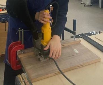

Step 2: Marking Out and Cutting Biscuits
Draw two lines which divide your cut panels length-wise one module at a time, referring to the CAD model to see which side of the panel the biscuits are meant to be cut on. Then, align your biscuit cutter and cut. This should be done for all panels, as the inserts for the specialized modules can be added later.
There are some biscuits which need to be cut in the middle of some panels, such as for component one, and you have to make sure that the two holes you cut align, although it doesn't matter exactly what distance they are from either side. I found that clamping down another thin piece of wood to hold the biscuit cutter against is particularly useful.
Afterwards, dry fit the cabinet together to see if you have cut your biscuits correctly.
If using acrylic for the wine cabinet inserts, mark and cut out those biscuits in the corresponding panels as well

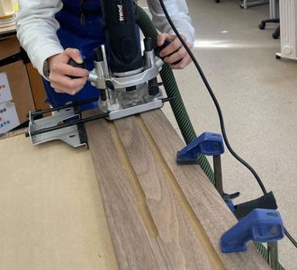

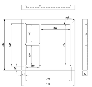

Draw out the designs on the 3rd and 4th picture on 2D design (or any app for your laser cutter), or refer to the model attached below. Then cut on the 7mm piece of MDF. Stick the cut panels onto another sheet of the same size to create a layer for your electronics to rest on. Optionally paint at the end with white paint.
Draw two lines length wise on your two panels for this module (component 7). Set up your router with a 14mm bit, and route along the line you just drew. Afterwards, sand as necessary until your laser cut dividers are able to slide in smoothly.

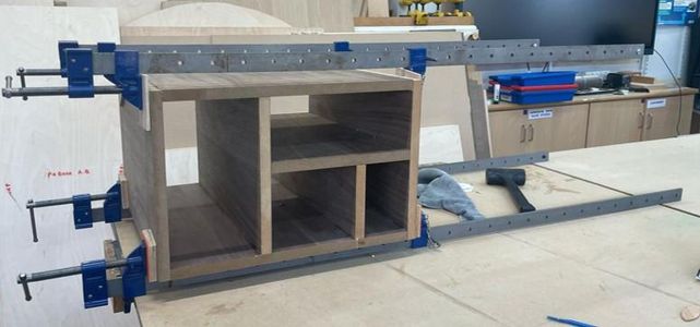

Step 4: Glue Together Modules
Glue together the panels into their individual modules using sash clamps, biscuits and wood glue. Refer to the CAD model as necessary for each module.
Do not glue wine cabinet module yet if you are using the thin MDF instead of acrylic.

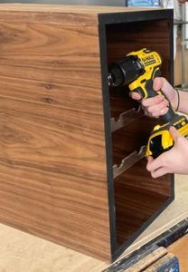

Step 5: Wine Cabinet
Referring to the CAD model, draw out the inserts onto 2D design (or any laser cutter app you use), and cut into acrylic or wood using a laser cutter. If using Acrylic, make sure to add 20mm on both sides of your design to be sent to the laser cutter, while keeping the original end point line engraved instead of fully cut. Also add two small holes the same size as your screws.
If it is cut out of acrylic, then use the line bender to heat along your engraved line. Bend both sides to 90 degrees, then mark out and drill into the outer panels at the desired attachment points. Do not drill the whole way through. Add in your screws, then manually screw them into the MDF using the drilled holes as a guide
If it is cut out of leftover MDF, then use the biscuit cutter again and biscuit. Then, attach them in and glue the whole module together.

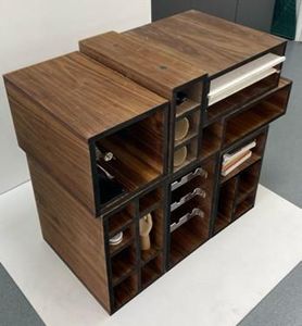

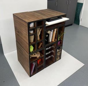

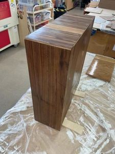

Step 7: Finishing
Use iron on edging all visible parts of MDF except for the front, hiding the strips of MDF visible from the sides due to butt joints.
Using the black stain, stain the front of the cabinet on the MDF parts using bits of a cut-up sponge or brush. Be careful of it dripping down the sides, since if it penetrates too far into the veneered sides, it would be very difficult to sand off.
Sand gently with the highest grit paper available since the veneer is at risk of being sanded off since it's only a thin layer. Sand the sides of each module until they feel smooth.
Then, apply your finish to all cabinet parts except the front.
