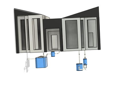

Step 5: Proposed Solutions
Requirement #1: Long-Term Drought Emergency and Extreme Heat
Solution 1: Butterfly Roof + Rainwater Harvesting System
Why: In drought-prone areas, capturing even small amounts of rain is crucial. A butterfly roof is designed to make the most of rare rain events.
How: Instead of sloping outward like a traditional roof, the butterfly roof slopes inward, directing all rainwater into a central gutter. From there, water is funneled into storage tanks, filtered, and used for irrigation or non-potable indoor needs like toilet flushing. This reduces reliance on city water, conserves a limited resource, and helps manage stormwater more effectively.
Solution 2: Graywater Recycling System
Why: In homes, a lot of water is wasted after single use, especially from showers, sinks, and laundry. Graywater systems give this water a second usage.
How: Used water from household sources is diverted into a separate filtration system, cleaned through multiple stages, and stored for reuse. It can be used to flush toilets or irrigate landscaping, reducing the need for clean water and lowering monthly water bills.

Step 8: Rainwater Harvesting
Problem : One thing that kept coming up when talking to my peers about this design was the rainwater harvesting system. They were concerned that the system I had in place for storage of the rainwater would be very hazardous to the residents of the home because the water would remain unsterile and prone to bacterial infestations.
Solution: To address this concern, I integrated a carbon-based filtration system into the rainwater harvesting setup combined with a UV filtering system in the main tank. This system filters out bacteria, sediment, and chemical contaminants, making the collected water significantly safer for all uses. Additionally, because I placed the storage barrels underground, mosquito breeding band algae growth will not happen. This solution ensures that the rainwater remains clean, safe, and usable.

Step 19: Overall Design
With our build complete lets now outline all of the features included with it
The butterfly roof as explained before is great for maximum water intake as well as being very efficient for solar panels exposure.
The modular construction and 3d printed geopolymer paste allows for fast construction and deconstruction, saving time, money and effort.
The photochromic windows allow for the windows to be a great source of natural light but also not unnecessarily heat up the house and make AC run longer.
The Greywater recycling system is shown here for increased efficiency in water usage. Also the rainwater collection system.
Finally solar panels take off the homes reliance from city power grids and allow the residents to have a steady flow of energy.
Step 20: Greywater Recycling System
Every year, homes waste a huge amount of water, often thousands of gallons, on things that don’t actually need clean, drinkable water. This leads to unnecessary costs and puts extra stress on the environment. For example, why do we flush toilets with clean water when we could reuse water from washing our hands or doing laundry?
That’s why I designed my own custom greywater system to help reduce waste and make homes more efficient.
Before explaining how it works, it’s important to know what greywater is. Greywater is used water from sinks, showers, and washing machines, basically, water that’s not too dirty. Water from toilets or kitchen sinks is not greywater and can’t be reused because it might carry harmful bacteria or grease.
My system includes two filters and one main storage tank. The first filter removes larger particles using a carbon based filter, and the second filter uses a natural, biological process to clean the water further. At the very beginning of the system, a sensor checks whether the water is safe to reuse. If it’s not greywater, it automatically gets sent to the sewer. But if it is, it’s cleaned and saved for later use, like flushing toilets or watering plants.
This simple system can help save water, lower bills, and make a big difference in how we use resources at home.
