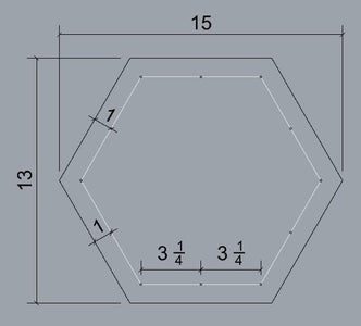

The first component of the kit is the plywood base. This piece is preferably cut in hexagonal modular shape, to allow the combination of several pieces to create a later wall composition. It is necessary to make some holes in the base, according to the diagram attached. This holes can be made with screwdriver and a thin drill bit.
he base has to be sanded on the surface and edges. An optional step would be to use any oil based treatment for sealing the plywood base.

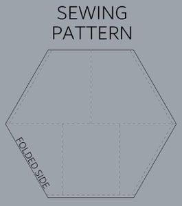

The goal in this step is to create the pockets for the plants. The material used is a medium density felt, that will give a great flexibility inside of the pockets and also support for the plants. Two layers of the same material are needed, the first layer (internal layer) is the layer that prevents contact of the plant and soil with the base. The second layer is the outer layer of the pocket.
It is needed to start with a similar single piece as shown in the FELT PIECE pattern, in such a way that you will have one seam-free side. The size of the folded felt, could be approximately 1/2'' offset from the plywood base shape.
After defining the felt, we will sew the felt itself following the SEWING PATTERN. Using the fish line as thread, start sewing with the needle with single stitches. At the end of this process the two layers will be attached together.

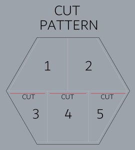

After that, it is needed to make 3 straight cuts, according to the CUT PATTERN. With the helps of the scissors, cut only the external layer of the felt.

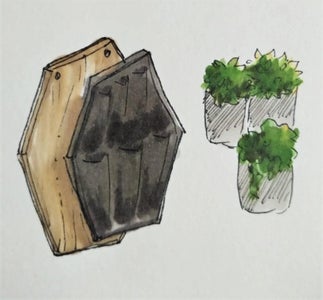

Step 3: Attach the Felt to the Base
Using the holes in the plywood base, attach the sewed felt piece from the previous step to the base. Using the fish line and the needle sew the felt with the base, going through each of the perforations. Do this procedure back and forth, so that the seam is tighter.

The module is ready! now you just need to place it where you want, it can be hung on a wall, or supported on a surface.
