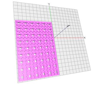

In the absence of a build plate with holes to support the tiles there are two options.
1: Take an existing baseplate and drill holes between alternate groups of 4 stubs with 4mm holes and 2mm holes between the other group of 4 stubs.
2: 3D print a baseplate complete with holes.
The size of the baseplate required is 96 mm (W) x 144 mm (L) or 12(W) x 18(L) stubs.
The design for the 3D printed baseplate was completed in BlocksCAD.

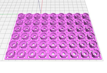

In addition to the baseplate there needs to be support for the Neopixels, this is also 3D printed and attached to the baseplate with 2mm self tapping screws.

Place the Neopixel support board against the baseplate with the flat surfaces facing each other.
Using four M2 x 6mm screws one in each of the 2mm holes in the corners secure the two boards together.
