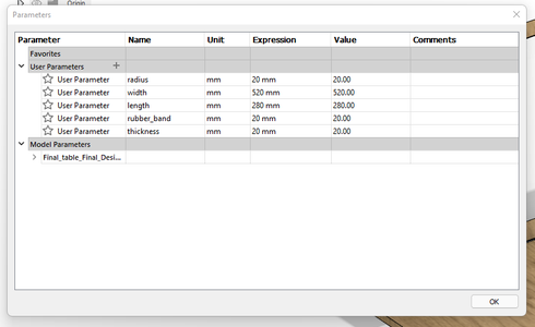

To allow you to alter the model to your own specific needs we provide all the drawings and models relating to this project. All these designs can be altered by changing the measurements that you can take from your own walker. By simply adding these in the parameter table the drawings and models will change in one go.

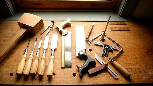

As for necessary hardware the list is very limited:
- Wood and super glue
- Stapler
- Screwdriver
- Knife
- Sandpaper
- Acces to a makerspace.

We take these measurements and fill them into the right places in the parameter sheet. This can be done in the design environment of Fusion360. By altering these measurements the models will be changed to suit your personal needs.

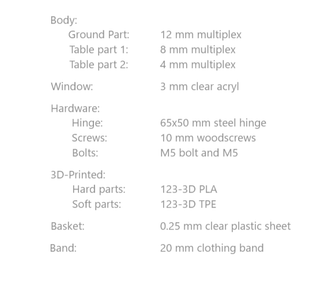

After going through the material matrix and writing down all the necessary materials you should go online or the appropriate shops to get all the needed materials.
A simple hardware store near you should have all the needed materials you are looking for ordering online is also a good option but will take more time.
The materials we chose are visible in the picture above, they were the best fit for our requirements and budget. You should however choose the materials that suit you best.
