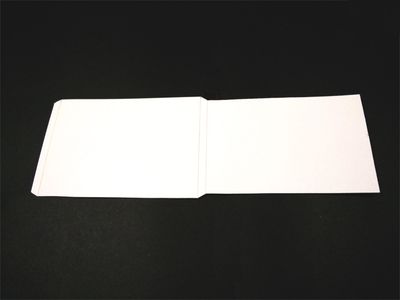

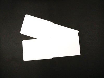

Draw the templates on the cardboard; there will be two (2) template A – for the top and bottom, and four (4) template B – for the sides. That makes it a total of six (6) cardboard ‘planks’.
Step 4: Fold the Cardboard
Crease the cardboard to make it easier to bend and fold. Fold the cardboard as an envelope for the corrugated cardboard.

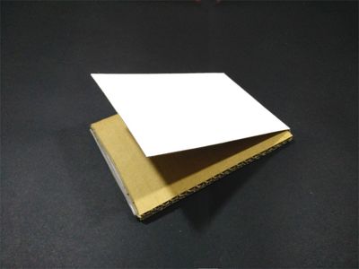

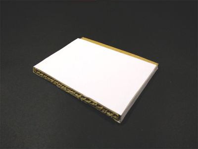

Step 5: Cut the Corrugated Cardboard
Cut the corrugated cardboard according to the size of the cut out template. Insert the corrugated cardboard into the folded cardboard. Apply a plenty amount of glue to ‘sandwich’ it together. Use the binder clip to clamp the cardboard while the glue dries.

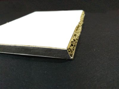

Once dried, cut the excess cardboard on both sides. Use the outer cardboard angle as a guide (that’s the reason for the sandwich cardboard).
The angle is important to attach the cardboard planks together. If the angle is a bit off, you’ll have a hard time to glue it together, and it wouldn’t shape like a perfect hexagon like we intended to.

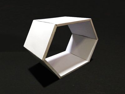

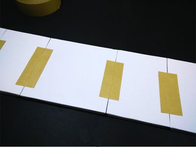

At this moment you'll have a total of six (6) cardboard planks. To make it easy to glue it together, first arrange the planks on a flat surface. Use masking/craft tape to hold the planks. Turn it over and apply glue along the connecting edge of each planks.
Next fold the planks to make a hexagon shape. Here's a tip on how to make sure your shelf is really hexagon. Draw a template of the hexagon shape (from the template in Step 2) on a piece of paper. While the glue is still wet rest the shelf on top of the paper. This serves as a guide for you to make sure that you have the exact hexagonal shape that you want.

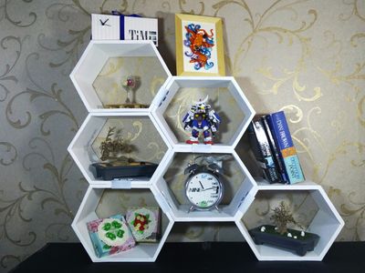

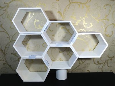

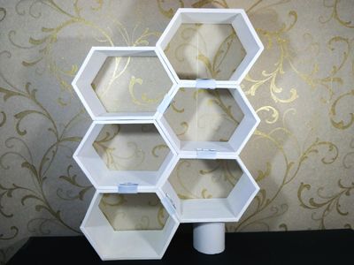

Step 8: The Secret of Modular Shelves

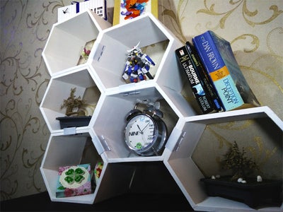

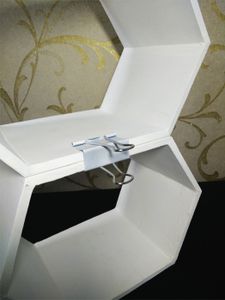

It wouldn’t be a honeycomb shape with a single hexagon so you need to build a few more shelves to stack it together. The secret to the modular shelving is the binder clip. I first spray paint the binder clip white to match the shelf color.
Use the binder clip to attach the shelves together. Once you clipped it in, remove the clip's handle.

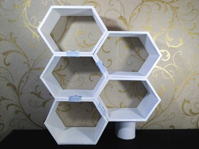

Step 9: Arrange the Shelves to Your Liking

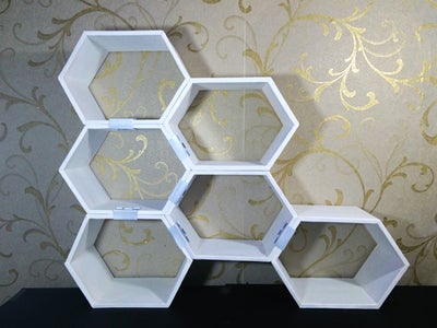

With the binder clip you can arrange your honeycomb shelves position and pattern to your liking. Hence I called it modular honeycomb shelves =)
