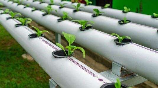

My first design was an Nutrient Film Technique (NFT) hydroponic system, a large horizontal PVC pipe with smaller pipes extending perpendicular from it, in the shape of an E. I hoped this would allow for different plant types to be grown from each section, and create a compact system that could be stacked (last image shows the system).
I decided against this design because I realized that a system using the same nutrient solution cannot grow many different plants that would require different nutrient concentrations (Hoidal, 2022). Also, I wanted to focus more on ease of use for students, so I traded a super space-efficient system for a tree-like educational model.

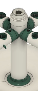

My design contains a large vertical central PVC pipe with a diameter of 4 inches that is filled with water using a flexible pipe attached to a pump at the bottom of the tube. In the most basic form, the design is just a single water tube, with no plants at all. Small holes with quick-disconnect pipes attached on the sides of the tube can hold any pipe module we design. We can insert many of these “branches” (3-inch diameter PVC pipes with planters cut into them) along the central “trunk” to create a tree-like structure with branches of planters.
The most important aspects of my design are the quick disconnect joints. The complex connection points and 3d printed components need to be sealed very well, and many hours went into 3d modeling to reduce points of contact with the water. I initially looked at mist hydroponics systems, but I thought that would be too complicated for use in such a small-scale product. Since we need the system to fit within a 2x2x2’ cube, excessive weight in water wasn’t a concern.

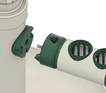

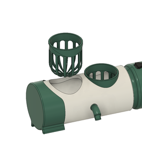

The branches are the most important part of my system. They are modular and separate pods that can grow two plants each, and can be easily removed or attached to the central pillar.
I started modeling these by creating the 3" pipe that they are based on. These pipes are under a foot long, and have 2.5" holes in them.

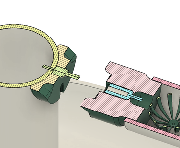

The most important part of these branches is the quick disconnect joint that connects the branches to the central trunk. These took many design iterations and testing to get working without slop or leakage. The quick disconnect component is simple in practice: it is a small 1/4" quick disconnect fitting that is glued in, using a special type of plastic bonding hot glue, and sealed with marine sealant.
In the sectional analysis picture, you can see how the parts are seated with the quick disconnect. During preliminary testing, I connected water hoses which were pressurized to both ends of the connection points and was able to easily press the top button to release and stop the flow and reconnect to reestablish flow.

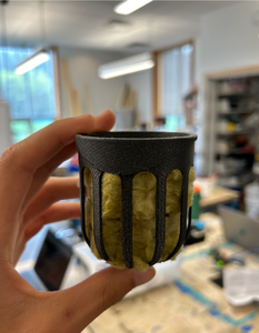

Step 4: Design Process - Plant Holders
These holes also have small plant pots above them that hold the growing medium—in my case, Rockwool. They are shaped to slot into the pipe perfectly without any rotational freedom.
I initially wanted to use off-the-shelf plant pots, but these were rather expensive, flimsy, and not shaped exactly like the sizing I had previously established.
I designed the slits to be large enough to allow easy water flow but small enough to keep the chunks of rockwool growing medium from falling through into the water circulation system. The top flange also has a sweeping shape to allow it to not rotate when placed tangentially to the branch PVC pipe.

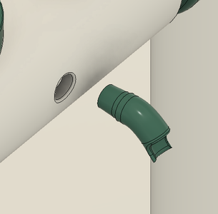

Step 5: Design Process - Spout
Since the water flow needs to be maintained at a constant rate, the water being pumped up into the branches needs a way to be cycled back into the system.
I initially wanted to put another set of quick disconnect fittings onto each branch joint, but I realized that it would be very hard to route both water in and out outlet in a single middle pipe. I then decided to have the water trickle out the end like a fountain, which would be an aesthetically pleasing way to create circulation.
I worked through a few 3D-printed prototypes until I settled on a longer, curved spout that would direct the water towards the central column to avoid splashing.

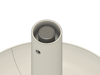

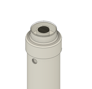

The central pipe is filled with water using a small pump and has holes drilled in it from the side to allow water to flow into the branches. It is made of a 4" PVC pipe cut to 24" long. If we look under the top cap of the central pipe, we can see that there is another 2" PVC pipe inside of the larger pipe. This addition serves to reduce the overall water volume from 301.6 cubic inches to 183.8 cubic inches, which is a relatively large reduction given the simplicity of the fix. This small change saves over 4.2 pounds of water from the final design, reducing the overall weight and time needed to fill up the tube.
The top of the pipe has an Arduino Oopla Kit mounted on it, which can be optionally fitted with many sensors to monitor water quality. Our design only has a temperature sensor, but it is possible to attach particulate matter sensors and pH sensors, two indicators that are very important for plant health.
There is also an emergency drainage port in case the water level rises too high and threatens to disturb the electronics.

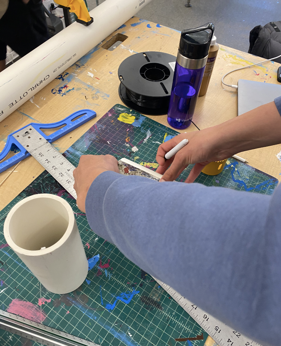

I constructed this project in my school fabrication studio using parts purchased from a local lowes. I cut all PVC pipes to size using band saws, and I drilled the large holes in PVC using hole saw drill bits.
I did encounter some hurdles while completing my design:
The hot glue I initially tested wouldn't bond very well with PVC and the 3D-printed filament I used, PETG. I used a variety of different glues, including epoxy resin and marine adhesive, before settling on a special hot glue stick made for thermoplastics and PVC. I completed the testing for these glues by attaching a prototype curved part onto the central 4-inch PVC and hitting it with a hammer to attempt to dislodge it (first picture). For the successful glue, I couldn't detach the part with a hammer and ended up actually breaking the part while it was still glued to the PVC pipe.
Many parts had small leaks that needed to be identified and fixed. These were sometimes almost microscopic, and I had to fill the whole design with water and wait for hours to see if there were any water spots forming.

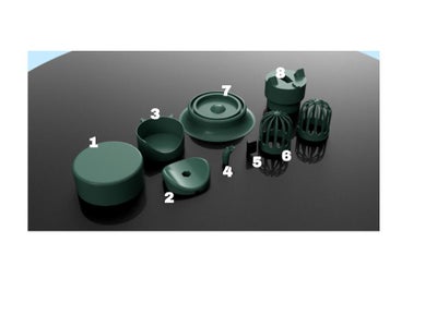

  1. 3D print all necessary components
The shown tray is only for one single branch; you need to increase the number of 1, 2, 4, 5, 6, 7 parts printed.
Refer to the above numbers in the following steps

  1. Cut 24" of 4" PVC
  2. Drill 1/4" holes on the side of the 4" PVC where you want the branches to be positioned
  3. Drill a small emergency drain hole anywhere on the 4" PVC where the max water level should be

  1. Use plastic bonding glue to secure the button (part 5) to the branch joiner (part 8)
  2. Use plastic bonding glue to secure the female quick disconnect fitting to the branch joiner (part 8)
