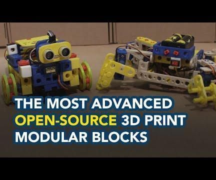

Introduction: Modular Ottodiy Robot
This project is a remix from Ottodiy project. Just using a different framework for the case build.
The modular blocks that I'm using to build this robot are called Blocky Codes, some of the features are :
- it is opensource,
- it's modular
- Optimized for 3D printing
- You can build lots of cool projects using Blocky Codes.
To learn more about Blocky Codes you can visit the website here
I also have written a Getting Started tutorial with blocky codes here, It's important to take a look at this tutorial so you know how to work with Blocky Codes and all the capabilities.
