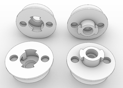

For each section you’ll need to assemble a male plug to put in one end and 1-3 females, depending on if it’s a one, two or three-way section. Note that the female assembly need a male plug and the male assembly needs a female jack.
Step 3:
The assembly of both the male and female connection is similar. The connector fits within two pieces and is secured by a third that could be either glued or screwed, or both. This ensures that the connector can’t be pushed out of the assembly.
It’s preferable to superglue everything to be sure nothing falls off later.

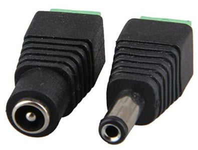

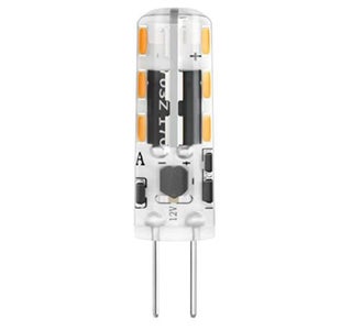

The lights themselves need some modification of the DC jack in order to shorten it down. It might not be strictly necessary but is needed to get the LED lamp in the middle of the globe.
Cut the jack as shown, cut through the plastic coating until you reach bare metal and pull off the plastic until you can solder the LED pins on the proper lead. +12V goes in the middle pin and the outer acts as ground ( -12V ).
Step 6:
The solder will keep the lamp secured to the jack. Glue the connector to the plastic part and then glue the whole assembly inside the globe.
