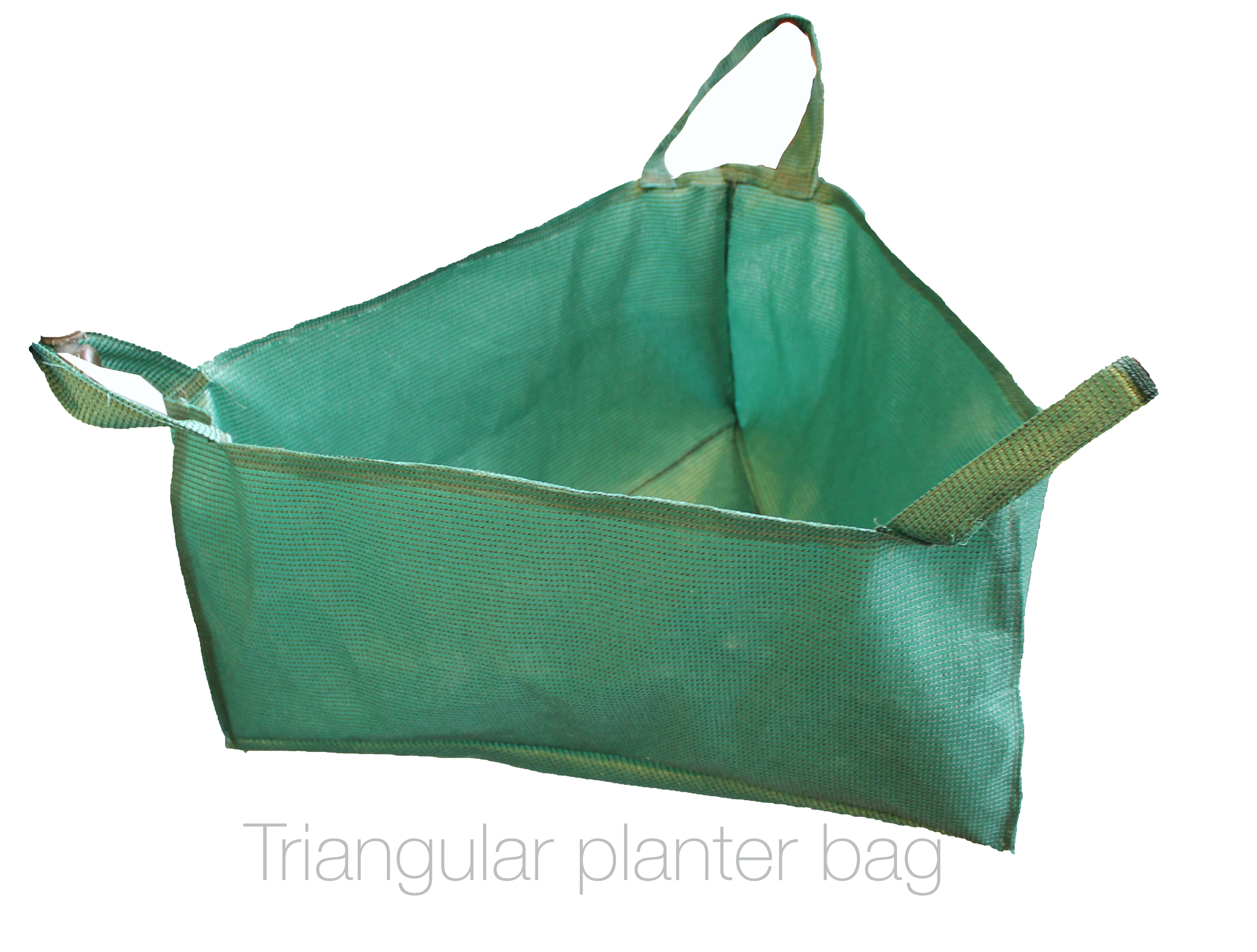

WHAT DO YOU NEED FOR THE GARDENING BAG
MATERIAL
Thread
Anti-rooting textile

Check out this instructable for knowing how to make the gardening sack.
https://www.instructables.com/id/Triangular-planter-bag/
