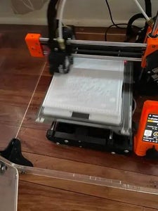

1.3D Printer- I used Prusa Mini

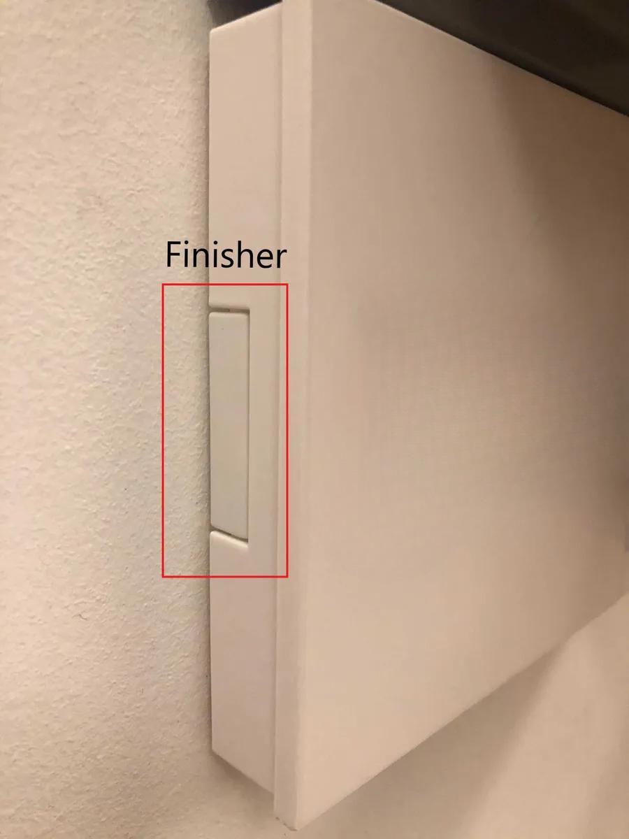

- The Finisher is the last and optional part, it is purely cosmetic it's to fill the "hole" from sides of the composition to improve the look from sides.

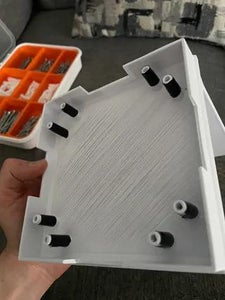

- The Main module and basic plates can be printed without supports
- The plates theorically don't need supports for the center part, there will be a long bridging and it will be ugly (see photo of the bellow of the plate) but it doesn't affect the functionnality of the plate and will connect to the module as expected. At least the most important part is the visible part. Also I strongly recommend to use a brim so that 8 circles connectors won’t fall during printing.
- The connector need at least 4 small support, please take the 3mf file of the connector, the supports are already pre-charged.
- All Advanced Plates needs supports
- I strongly recommend to print 0.15 or lower layer height for the connector and main module

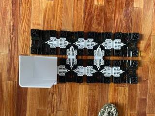

Step 2: Printing Modules, Plates, Connectors
- Print as much as main module as you want
- Print as many connector as needed to connect Main Module to each other (for 3 Main module you need 2 connector)
- Print the desired Plates for each of your printed modules.
Step 3: Removing Supports
Remove the 4 thin layer on the connector this thin layer exist in order to avoid supports in this zone.
Step 4: Connecting Main Module Together
Connect each modules with the connectors to form the shape you want, to know if a module is connected you push the connector until you hear a "click" sound you can push a little on the two side bar like on the photo for an easier fit. (it is also that way that you can disconnect modules)

Step 7: Adding Finisher (optional)
You can print and add finisher on the edge of each module which isn't connected to another module in order to have a smooth view from the sides
