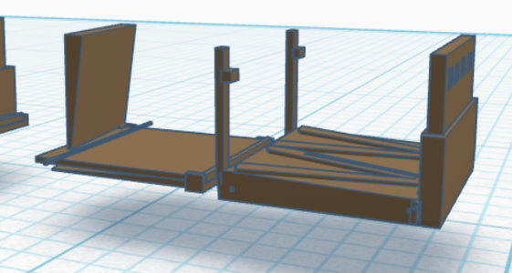

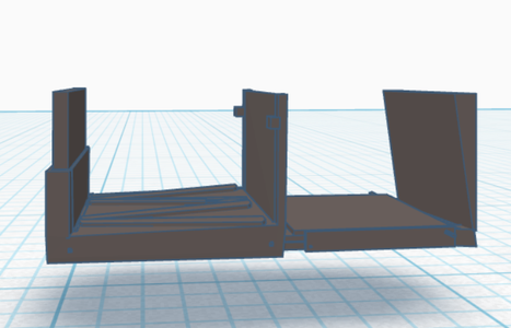

Attach different surfaces together using glue (if you are working with cardboard or wood) to assemble Modustack's parts. The first unit's top surface has a slight tilt for drainage and many 'V'-shaped separations to align bases of ranging dimensions neatly.
For your reference- In the first picture, you'll notice the first and second units without flaps. The second picture is of the Modustack's complete assembly, and the third picture shows an expanded version of the model. The last three photos are of a working model which I built of the Modustack.
