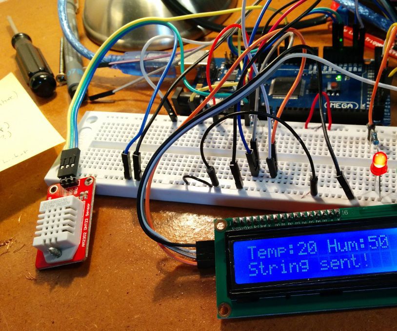

The layout is dead simple:
One nail goes to the +5V line on the Arduino. The other nail goes to an analogue pin (zero in my case) but also to the 10K resistor and then to ground.
Easy as that!
What we're effectively doing is putting +5V through the soil (with one nail) and detecting what we can with the other nail. The more water in the soil, the less resistance we'll get (and vice versa).

Step 3: The Result
To view the output you need to open the Arduino IDE serial monitor.
I have the nails all the way down in my plant pot, but play around with one nail part in, both part in, and you'll see that you get different results depending on the placement and depth of the nails.
For my little plant the sweet spot was around 695 to 705.
