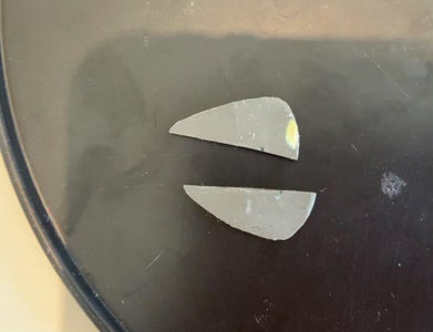

Step 6: Covering the Shape
  1. Use the cookie cutter to cut out a thin slice of background color (I used my gray shade).
  2. lay the shape over a large enough piece on veneer. (remember that in this case the 'nice' side of the veneer should be facing down.
  3. gently roll over the shape.
  4. flip the shape over and use the cookie cutter to trim the edges of the veneer off.
  5. cut the shape in half- creating to long earring pieces.
  6. smooth down the edges in the center with your finger.
  7. Flip the earrings over and place veneer pieces on top.
  8. cut the excess of with a sharp blade.
