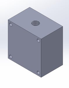

Step 6: Manufacturing Phase: Mold
The mold is a prototype that is already available at HAN. The mold needs to be developed and improved to make it as a working piece. The molds have a size of 60x60x32 (in millimeters). Several steps need to be done before the mold can be placed and used for the demonstration with the injection molding machine (and the above-manufactured connector). Here are the several steps that need to be taken :
  1. Use 4 pairs of screws and bolts (M5) to tighten the mold (and drill a hole between the two mold's plates, so the result will be symmetrical - see next step).
  2. Drill the main intake hole with the size of a 4mm drill bit for a 10mm depth.
  3. Drill 7mm down to the main intake hole with the 8.5mm drill bit for the thread (8.5mm is selected for an M10 tap, based on the above 'tap chart - metric coarse tapping drill size').
  4. Tap the hole with an M10 tap to make the female thread. (Using straight cutting oil is recommended to make the result smoother and less effort on tapping)
  5. Make air vents at the bottom of the mold with a small-sized file.
One of the molds has 3 air vents to make the process easier. It's placed at the bottom of every edge of the mold. An extra air hole is being placed because the previous test shows an air bubble on the edge; this is some action to prevent that from happening.
