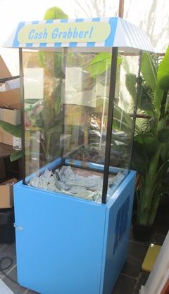

Our design was a miniature version of a cash grab inflatable game. See the photo for some inspiration on how we designed our money blower. The final design that we selected was based on a museum podium concealing the high-powered blower and tubing. On top, there's a display case to view the swirling bills. As long as there's a vertical space for the bills to fly and air to escape, you should be in good shape.

In our design we decided to build a museum-esque podium to prominently display our money chamber. Since our display case is 10" x 10", it's crucial to have an opening that matches those dimensions. As you can see in the photo, it's sized accordingly.

1. The bottom angled channel method (pictured). Create a four-sided angled cone that flows the bills back into the airflow. When the airflow is coming from the bottom direction, you'll need to install a mesh grate over the opening so the bills don't fall straight in. The angle of your cone will vary on your design but something a little steeper than 45 deg is desirable.
2. The bottom/side airflow entry method (not pictured). Using a box that matches the size of your opening, use an opening on one side that matches the tubing and then a steeply angled piece of cardboard/wood that channels the air upward and the bills downward. This will create a swirling motion within the chamber and a natural path for the bills to fall back into the airflow.

Crucial step regarding airflow: You must create holes in the top of your display case for the airflow to exit. We laser cut small circular holes in the top of our display case. In our version, approximately 70% of the top was removed so the majority of air could exit without bills escaping.

Please note that crumpled bills are much better at swirling because they catch the air more easily and don't get stuck. You'll also need to determine the right amount of bills and the desired airflow setting...
This stage will require some trial and error to get the proper amount of bill swirling and tumbling. In one test, we added ping pong balls to the bottom of the display chamber to agitate the bills. They weren't required after final testing but did add some cool sound effects.
