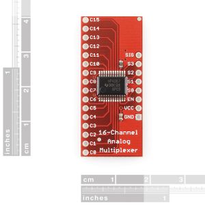

This magic is happening with the help of 16 channel analog multiplexer module. With this module, we can interface 16 analog sensor and switch them with the help of four digital pins. So in total, the pins occupied on esp side will be
4 digital pins
1 analog pin
