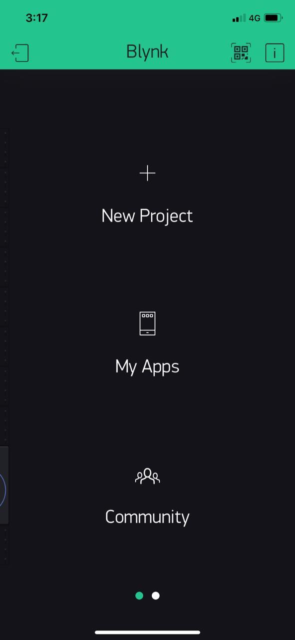

Step 5: Installation of Blynk App and Configurating the Workspace
Install Blynk App in your smart phone then create an account, after signing in the app select new project (the authentication key will be sent to your email). Next on the new project page type in the project name (for example HomeTemp & Humid) and select the type of device used for the project select NODE MCU and on the connection type select WIFI.

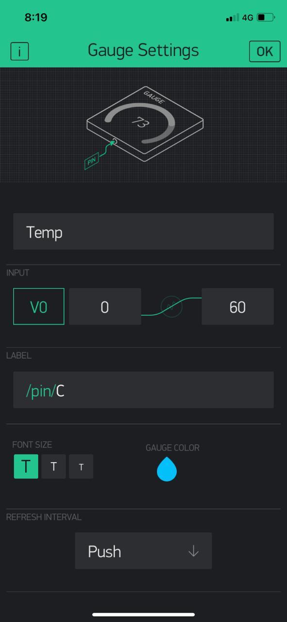

Now the platform is ready, press on the work space to select two gauge and align them in the workspace. Then select the first gauge call it Temp and select the input as virtual 0 (V0) also define the maximum value for the Temp (60) and for the label type C for Celsius s. Additionally do the same for the second gauge, but this time select virtual (V1) and because the humidity is percentage so define the max value as 100 and percentage sign for label, for both values make the refresh rate as one second. The figures above explains the process of configuring Blynk pages. There are some parameters that can be altered as user wish.
