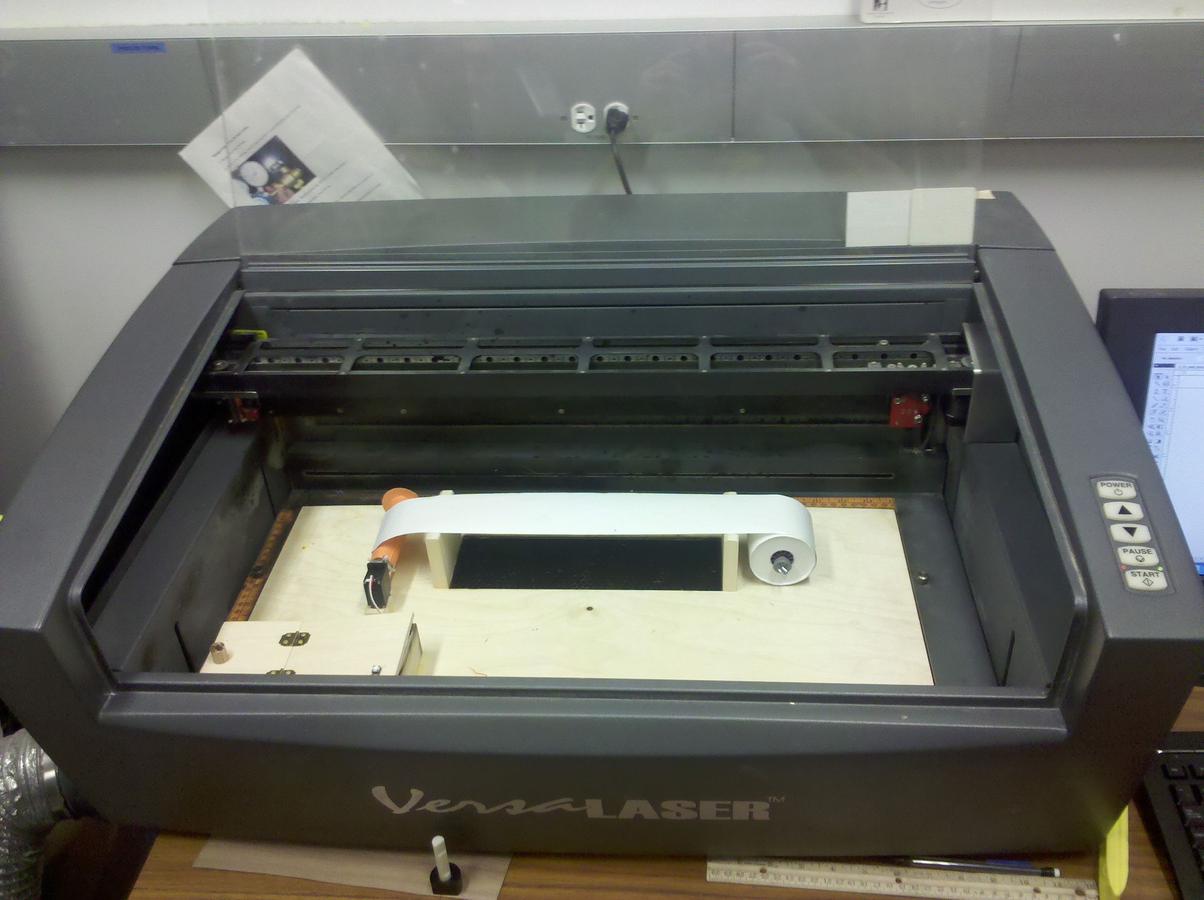

… And a platform to sit the monkeys on! We built our platforms as four sided wooden boxes that were open on the sides. The main platform that housed the Arduino, Motor Shield, and Battery Pack was slightly larger than the other two. It would also be possible to build a single platform for all three monkeys but we felt individual platforms increased the scalability of the project for future additions.

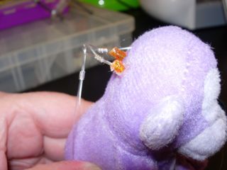

For each monkey, 2 fishing lines are used to connect the arms to the face (eyes, ears or mouth) through a plastic tube.
A third line is connecting the first two behind the monkeys head. This line is then routed through the top of the platform where the monkey sits and is connected to the servo. When setting up the monkey, platform, and servo some adjustment may have to be made in the length of this third line to get the most realistic movement from the monkey.

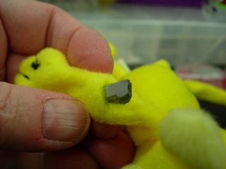

Finally the switch and connecting wires were inserted in the head of the speak no evil monkey and positioned behind the eye. In our project this switch controls all the movements and the speaker. We ended up tearing out the original paper eye that is on the monkey for testing but later replaced the eye with googly eyes on all the monkeys.

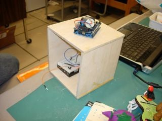

As we mentioned before our platforms were designed for scalability. To that end we built three separate platforms, one for each monkey. The platform that housed the Arduino Board and Batter Pack was bigger than the other two. All three platforms were designed with four walls, leaving the sides open to work inside the platform and to connect the servo to the Arduino.
In the top of each platform we drilled two holes, one to fit a dowel that was inserted in the monkey to hold it in place and another behind it to route the wires and fishing line through the platform and either to the Arduino or the servo.

So now we have a completed circuit board, some monkeys, and some platforms. It’s time to put all of this together. The first step is to insert the dowel into the monkey then glue the dowel down into the top of the platform. Once this is done route the fishing line and wires through the hole behind the monkey that was drilled out for this purpose.
We suggest putting together the monkey that will be on the platform containing the circuit first. For our project, this was the See No Evil Monkey. This will allow you to test your circuitry (although you should have been testing the entire way!) and make sure at least one is working before moving on to the others. Trust us, once one is working the others are a lot easier!
