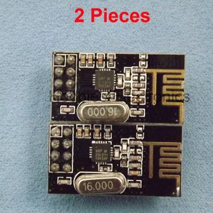

An nrf24L01+ wireless transceiver (see picture)

And I wrote an Instructable on using the nrf24L01+ transceiver:
https://www.instructables.com/id/LOG-Wireless-Temperature-Monitoring/
