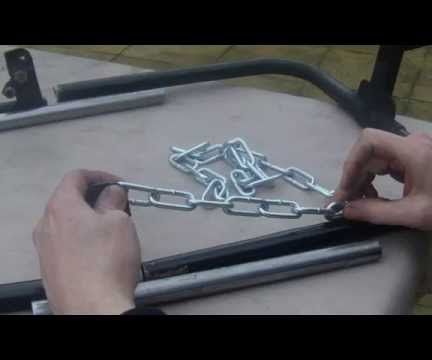

Step 1: Mono-wheel Motorcycle Trailer Rebuild - the UJ
Here we have the the fitting, and makeup, of the UJ (Universal Joint) and a little of the hitching method. This is vital the the running of a single wheeled (mono-wheeled) trailer system, it gives stability and helps manoeuvrability of the bike.

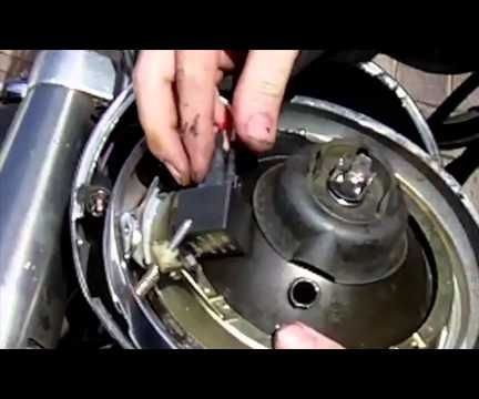

Step 3: Mono-wheel Motorcycle Trailer Rebuild - Electrics
Here we have connecting the trailer electrics to the bike.

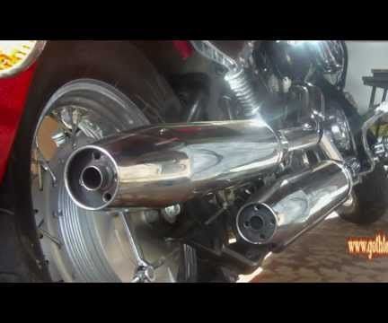

Step 4: Mono-Wheel Trailer Test Ride
As promised a video of the trailer in action, with added panniers. The Test Ride!
