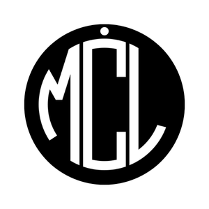

Step 2: Generate Ornament Design
Time to bring your monogram PNG into Canva and add those finishing touches that’ll take your design to the next level. Canva is super user-friendly, so this step is as fun as decorating cookies (but way less messy!).
Upload Your Monogram PNG
Fire up Canva and start a new design. I like to use a custom size canvas that’s roughly 6x6 inches—it gives you plenty of space to work with. Upload your monogram PNG by dragging and dropping it into Canva or using the “Upload Files” button. Once it’s uploaded, drag your monogram onto the canvas and center it. Look at that—you’re already on a roll!
Add the Black Circle Border
Click on “Elements” in Canva and search for a circle shape. Once you’ve got one, resize it so it frames your monogram beautifully. This will be the outer edge of your ornament. Adjust the border thickness by dragging the edges or using the size settings—go as thick or thin as your heart desires. Make sure the circle is set to black to give your ornament a bold, clean outline.
Add a Tiny White Circle for the String
Here’s the fun finishing touch! Grab another circle from the “Elements” menu, make it white, and shrink it down to about the size of a small bead. Place it at the very top of your monogram, above the middle letter, so it looks like the spot where your string will go through. Center it perfectly—you can even use Canva’s snapping guides to help you line it up like a pro!
Step Back and Admire Your Work
Take a second to look at your design and adjust anything that doesn’t feel just right. This is your ornament, and it’s all about making it match your vision. When you’re happy with it, pat yourself on the back because it looks incredible already!
Download Your Masterpiece
Once everything is looking just right, hit that “Download” button and save your design as a PNG file. Make sure to select transparent background if you have Canva Pro—it’s a lifesaver for keeping your design clean and ready for the next step!
And that’s it—you just gave your ornament some serious personality. Next stop, turning this digital design into a shiny, real-life masterpiece
