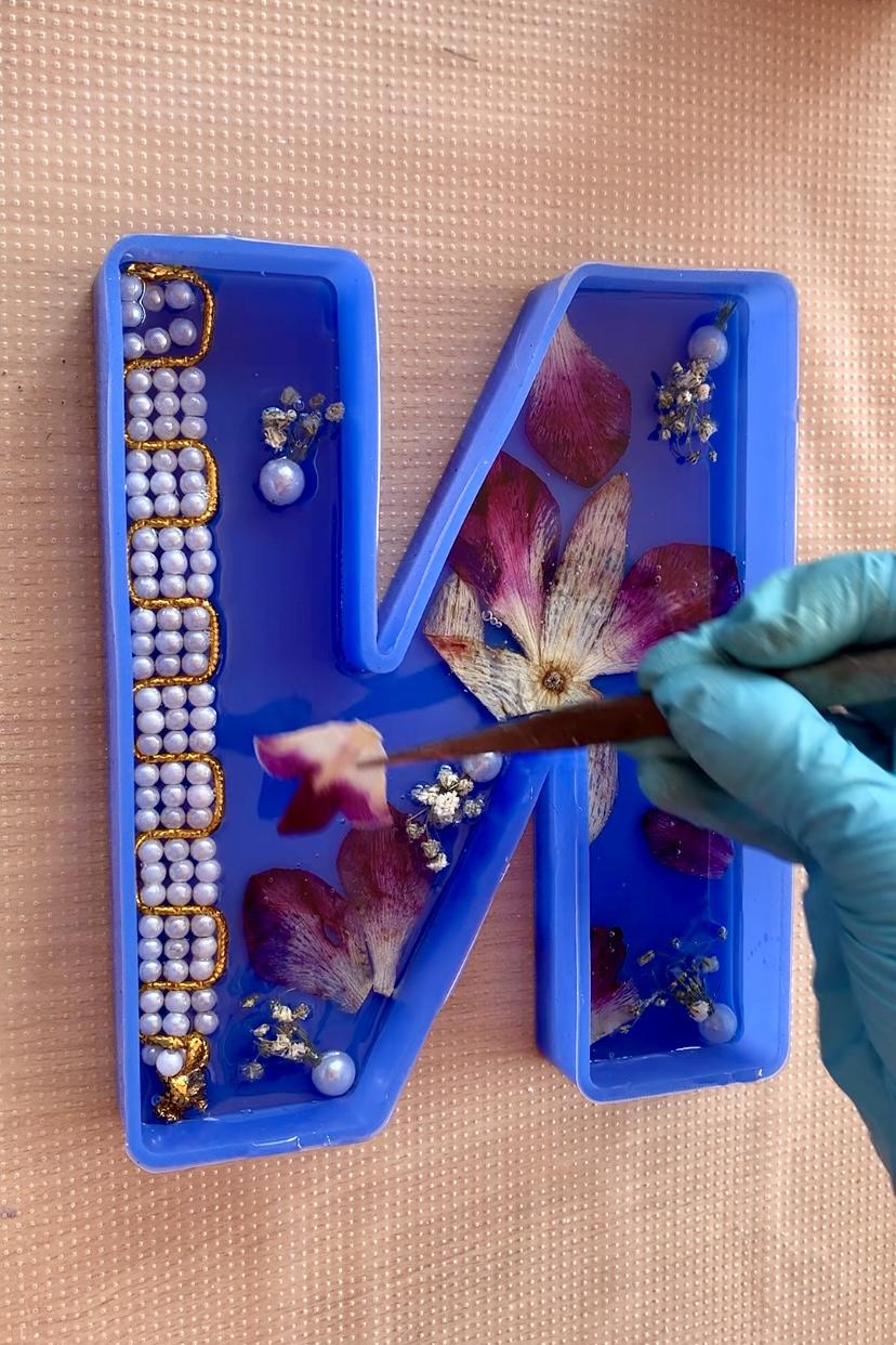

Step 8: For Alphabet N
Repeat the process as from step 3, Pour epoxy resin place the acrylic pearl belt , place baby breath bouquet randomly and start placing your orchid, Placed a 5 cm orchid in most spacious part and filling the rest of space with petal and smaller version of it. Final touch of drizzling baby breath head all over the mould. After 24 hours pour
