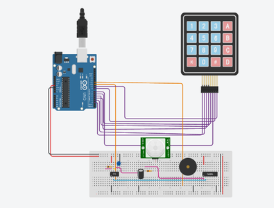

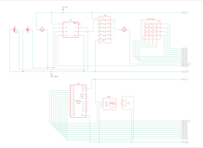

Step 2: Schematic of the Circuit.
This is so you could a better look at the schematic, if you understand this you can use this to build your circuit, otherwise you can go to the next step and look at the steps for wiring.

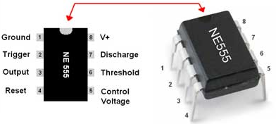

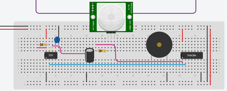

First, start with connecting 555 timers: let's start wiring the alarm with the 555 timers with the motion sensor. I made my circuit in Monostable where the motion sensor is the input, and when motion is detected the buzzer will go off. A monostable mode is when a 555 timer has one input that starts the circuit. So what you should do is make sure that the polarized capacitor is connected to the ground (negative pin) and connect the positive end of the polarized capacitor to the threshold. Connect terminal 1 of the blue capacitor to control voltage and terminal 2 to the ground. connect the 10k ohm resistor from power to the discharge pin of the 555 timers. Use a wire to connect the discharge to the threshold pin. Connect the trigger pin to the output pin of the NOT gate (7404), from here connect the input pin of the NOT gate to the signal of the motion sensor. The reason I have a NOT gate in this circuit is that without it, the circuit does the opposite of what I want it to do when the motion sensor detects motion, the buzzer will stop, and when there's no motion the buzzer will be on. I know using a NOT gate would switch what was happening because the NOT gate produces the opposite of the input. From here just add any pin from your Arduino to the out pin of the 555 timers and the positive pin of the buzzer.
Connecting the 555 timers in monostable is one of the most important steps for this project as this is this will actually help to turn the buzzer once motion is detected.

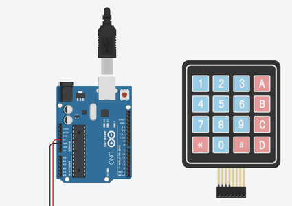

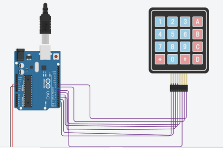

Second, connect pins to the keypad: One of the easiest steps to do is to connect the Arduino pins to the keypad, first, connect pins 2,3,4, and 5 to the 4-row pins. Then connect the digital pins 6,7,8 and 9 to the 4-column pins. (you can use any digital pin and any analog pin for this).
This will ensure that keypad can be clicked for the buzzer to turn off in this project, after you finished connecting the components start coding.
