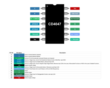

Step 1: Pinout of CD4047
The pinout of the CD4047 was illustrated in the above image. The explanation provided is clear and easy to understand, making it straightforward to identify and utilize each pin for various applications. The detailed diagram helps users quickly grasp the functionality and connections needed for effective use of the IC.

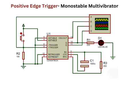

Step 2: Circuit Diagram of Monostable Multivibrator
The Monostable function, as its name suggests, has one stable state that shifts to an unstable state when triggered externally. After a set period, it reverts to its stable state, often used as a timer in various applications. While modern microcontrollers offer more capabilities, the CD4047 is preferred for its speed, efficiency, reliability, and cost-effectiveness for certain tasks.
Actually, there are up to 4 modes for Monostable Multivibrators in the CD4047. So we will utilize the first Mode Positive Edge Trigger Mode.
The circuit diagram given above shows the Positive Edge Trigger Mode configuration of the CD4047 IC. Key connections are as follows:
  • Pins 4 and 14 to +5V.
  • Pins 5, 6, 7, 9, and 12 to Ground.
  • A 1000µF capacitor between Pins 1 and 3.
  • A 400Ω resistor between Pins 2 and 3.
  • An LED with a 220Ω resistor to Pin 10 (Q).
  • Pin 8 (+TRIGGER) to +5V via a pushbutton and pulled down with a 10kΩ resistor.
  • An oscilloscope connected to Pins 8, 10 (Q output), 11 (Q‾​ output), and 13 (OSC output) to observe waveforms and timing.
Step 3: Calculation of Pulse Width
The timing (tM) for all modes in the Monostable Multivibrator is calculated using the formula: tM=2.48×R×C
For instance, with a capacitor of 1000µF and a resistor of 400Ω: tM=2.48×400×1000µF=0.992 sec
This can be approximately considered as 1 second.
