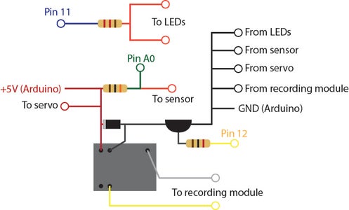

Since there are a lot of components being controlled by the Arduino, I created a simple circuit board to hold them and (somewhat) cut down on the number of spare wires. The board consists of a relay/transistor circuit to turn the sound on/off, a voltage divider for measuring the incoming light, and a basic LED circuit for the glowing eyes. This is the layout that I used, but you may choose to move components around so the cables going off the board make more sense.
Step 2: Controlling the Sound Player
Normally, the recording module works by having the two circuit halves physically connect when the "play" button is pushed. However, I wanted to be able to control the Arduino, so I needed a way to connect the two sides of the button using circuitry. I chose to use a mechanical relay, which is essentially a switch that connects a "wiper" pin to one of two sides when the relay is on and defaults to the other side when the relay is off. I only wanted the sound to play (the button to be "pushed") when the Arduino commanded it, so I connected the two sides of the button to be normally open (not connected) when the relay has no power.
The transistor is used to control the relay's connection to power. The base is connected to an Arduino pin, and when the pin is HIGH the transistor acts as a wire, connecting the relay to ground and turning it on. When the pin is LOW, the transistor acts as a short circuit and the relay remains off. (the mechanics of how it works are much more complicated, but for my purposes the transistor acts as a current-controlled switch).

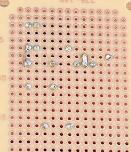

Step 3: Solder the Components
I usually start with the largest component, in this case the relay. Take care that it rests flat against the breadboard.
Next, I soldered the diode and the transistor in place. Make sure your diode is facing the right way! The silver line corresponds to the line in the schematic symbol.
I then soldered the 10K ohm resistor for the relay circuit, and the two 1K ohm resistors for the LED and sensor circuits. The middle pin (base) of the transistor I soldered to the nearby 1K ohm resistor.

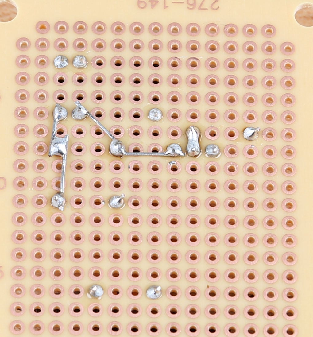

Step 4: Create the +5V and GND Rails
Both the relay and the sensor circuits have 5V inputs, so I created a "rail" of 5V along the side of the board to easily connect to power. I wasn't thinking and used two pieces of wire, but it would be easier to just use one longer piece.
Similarly, I made a ground rail to connect all the ground ends.

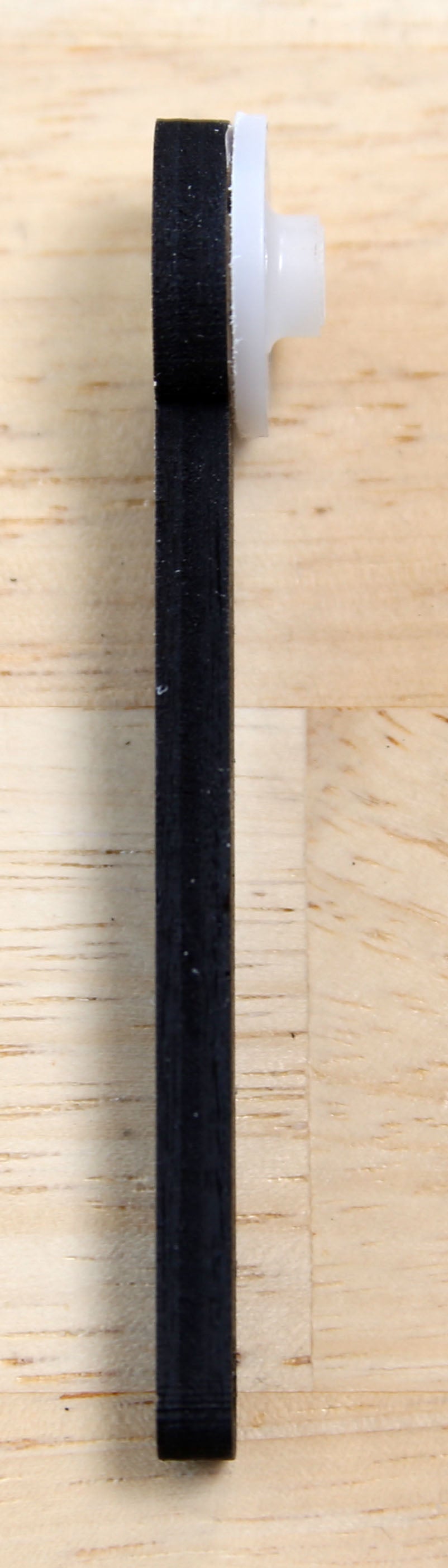

The arm needs to be securely attached to the servo horn (the round plastic bit that comes with the servo itself). I sanded the surface of the plastic a bit, then used hot glue to secure it. The servo comes with a small screw for attaching the various servo horns that will keep the arm from falling off.
