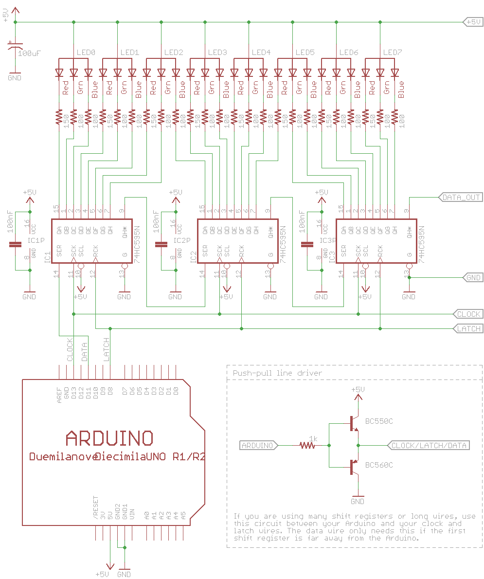

Step 3: Schematics
Lets look at the schematics. Don’t be scared its very simple. A shift register requires three signals to work. Data, Clock and Latch. You can see Kevin Darrah’s video here.
But here is my simplified version.
Here are 8 screws because all Shift Registers are 8bits. And these small ones are zeros where as the bigger ones are ones. These three switches are Data, Clock and Latch.
The Data pin decides if we are going to send in 1s or 0s. The clock pin sends in the actual data and Latch pin moves the data to the output. Right now all is zero. If I press Data and Clock together because data switch is set to high every time I push Clock a one is being pushed into the shift register. Right now I pushed it twice. But to show them to the output that is the LEDs you need to latch it. So when I push it all the 1s will turn to the output and the LEds light up. Because I pushed two times just the first two LEDs light up. Now to push in 0s I don’t have to press Data but just press the Clock button. So I am going to push Clock twice and once with the Data. So that’s two zeros and one one. Now when I push the latch its going to push them to the output. And here you can see that the first two leds are pushed by 3 places. Two zeros and one lighting up.
So all the shift register does is push data from one pin to the other. And when we cascade another shift register with the first one, the latch and the clock pin remains same for both the shift registers. Meaning the same signal that we connect to the first shift register will be connected in parallel with the second one. But the Data line will be connected just to the first shift register. The Data line for the second shift register will be the output from the first shift register.
That’s all there is for you to know about how shift registers are used in this circuit.
Now back to the schematic.
Here are the three shift registers connected to eight RGB Leds through resistors. Because connecting LEDs through resistors always is a good idea. But for me it worked without the resistors. And at the end you can see the pin 9 of the last shift register gives out the Data out for the next set of shit registers. Where are the Latch and Clock signal remain the same for all.
