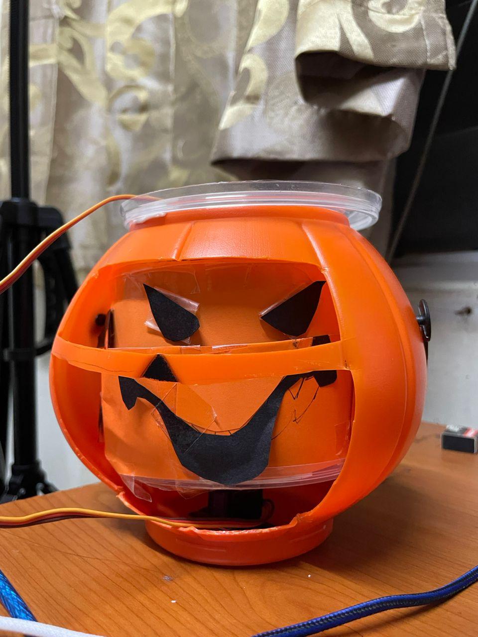

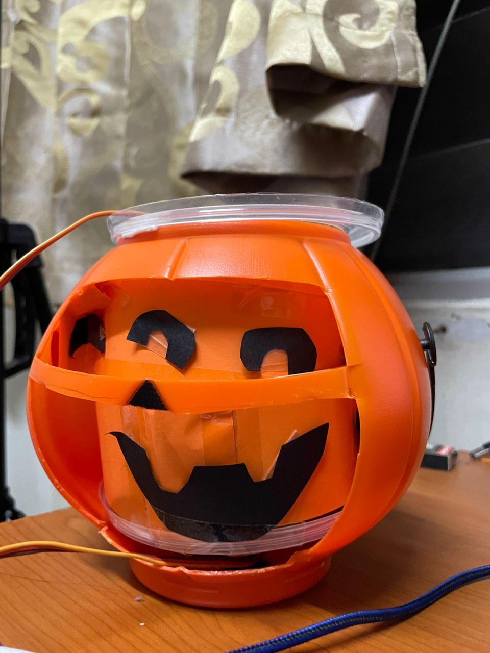

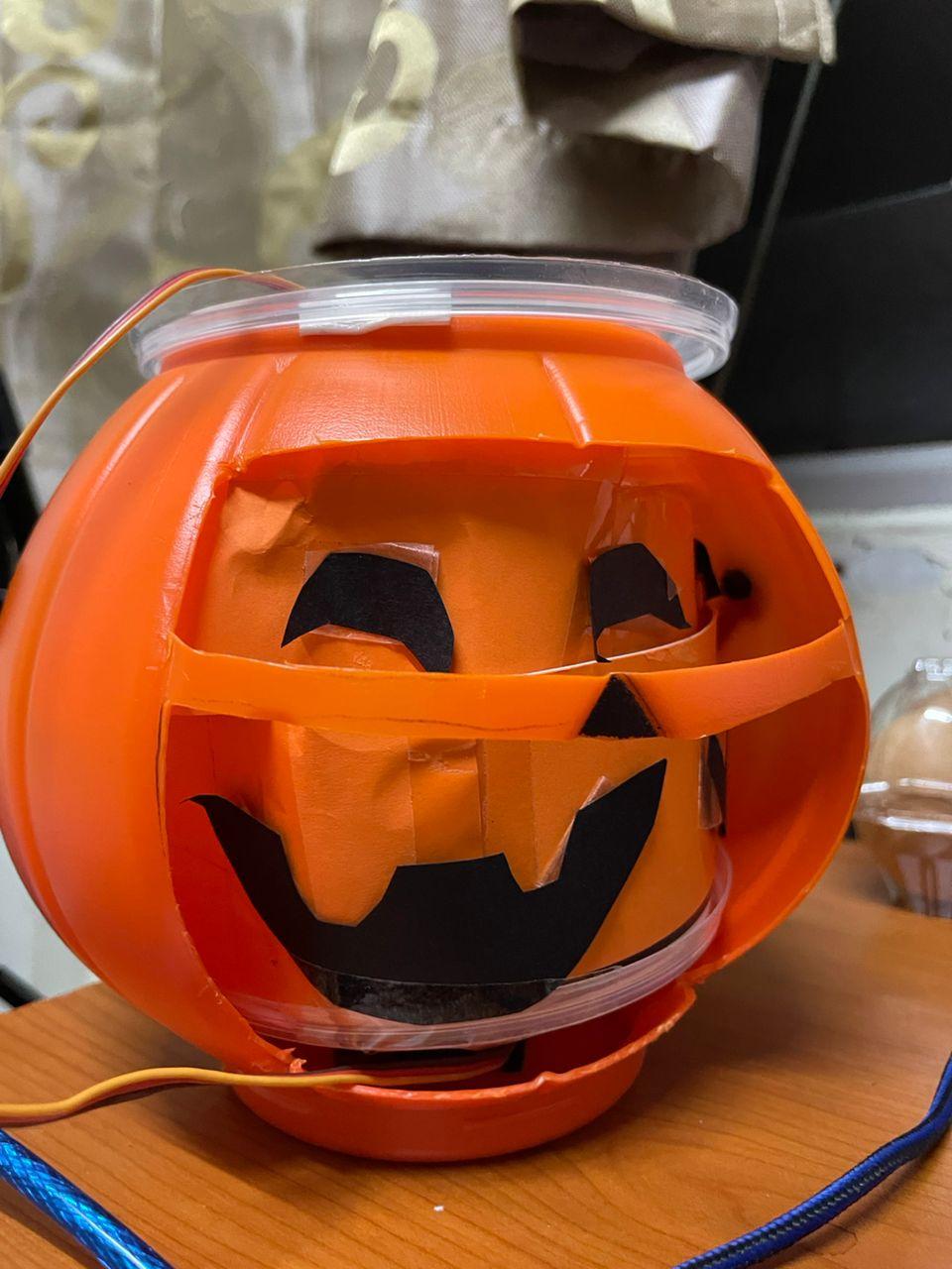

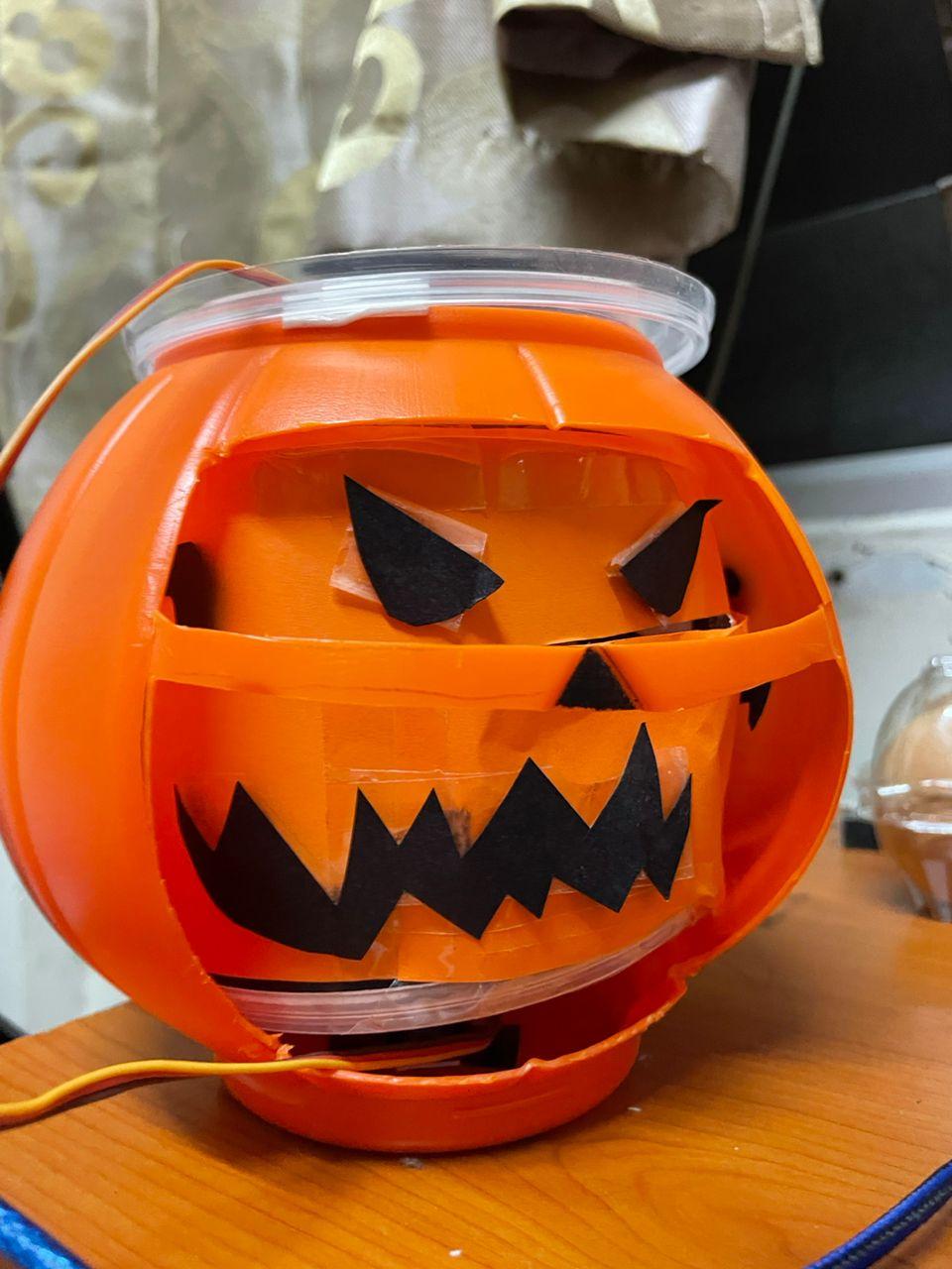

For this motor servo, 180 is the maximum rotation degree it can achieve, thus if you are looking for more faces, other motor servo or motor can be considered. Both the eyes and mouths are atttached to a cylinder like card to be attached to a round plastic cover connected to the motor servo.

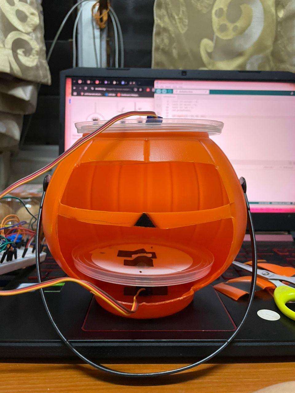

Step 5: Assembling
  1. I first remove the eyes and mouth part of the pumpkin based on the face of the pumpkin.
  2. I then attached the motor servo to a reused plastic cover. One motor servo is placed on top of the pumpkin while the other motor servo is placed at the base. Each motor servo rotates independently to create randomized faces with more variations.
  3. I created orange colored cylinders using orange paper attached on cards to be placed around the plastic covers. The cylinder is filled with eyes and mouths of Mood-O-Lantern before putting it back inside the pumpkin.
