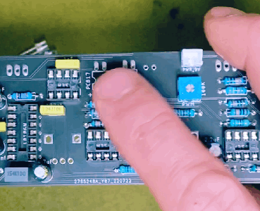

Step 2: About the PCB
Before we start to add components to the PCB, I thought I would go through a couple of things that you should know.
What is that cutout section for?
I always try to add as many components to the board as possible. It means less wiring and less hassle. Unfortunately I couldn't find a DPDT (Double Pole, Double Throw) PCB mounted switch which sat low enough on the PCB. To compensate, I made a cutout on the board and the switch is secured directly into the front panel. It means you have to wire it up but that is straight forward
Why is the PCB double sided?
Most of the components like IC's resistors etc are on one side and the on the other I have the pots, switches etc. This is to ensure the front panel will sit flush and the components don't get in the way
What the hell are those weird resistor values!
To be able to have the keys in tune, you need to create a resistor ladder at very specific values. It's probably the trickiest part as you can either take the easy road and just find close values or add resistors in series and get as close as possible. The closer you are the more 'in tune' the keys will be. It's tricky though because if you are out then this will compound and will mean the rest will be out as well.
Step 3: Adding the Components to the PCB
As mentioned, the PCB is double sided. Always start with the side with the resistors, caps etc and then move onto the other side which has the pots, switches.
STEPS:
  1. First thing as always is to start with the lowest profile parts - in this case the resistors
  2. When you come to the resistors for the keys (the ones with strange values, as previously mentioned, you can either just find a close value and add that or you can add a couple in series to try and get as close as possible to the values. You can see that I have done this in the 2nd image.
  3. Next add the IC sockets, polyester caps and trimmer pot. The trimmer is used to fine tune the PWM later on.
  4. Before you flip it over and add the rest of the components, you first need to make some vactrols!

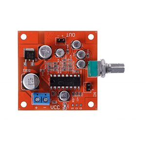

Step 5: Reverb & Echo Board
The echo and reverb board makes up the delay section of the synth. The module is cheap to buy ($3-5) and can be modified a few different ways. Shoutout to mayasfinest who provided the feedback mod.
As I already did the mods to the module (and don't have another spare!) I put together a wiring diagram which shows you what you need to do in order to mod the board.
STEPS:
  1. First remove R27 resistor on the module. You can use an exacto knife to do this and just flick it off
  2. Next, you need to remove the potentiometer that is already soldered onto the module. This is the reverb pot and we'll be attaching another one later on wires connected to the solder pads. I have found that the solder pads are easily removed form the module so I just use some wire cutters and cut away the pot.
  3. You now have to connect some wires to the reverb solder points and also to the solder points for the echo pot. I use computer ribbon wire here and it works great
  4. Once you have the wires added, solder a 50K pot to each end of the wires.
  5. For the feedback section, you need to add a little solder to pins 3 and 8 on the IC.
  6. Connect a couple of wires to each of the pins and then solder the ends to a 1M pot
  7. the 'in" on the module is connected to the 'out' on the moog PCB
  8. The 'out' on the echo module is connected to a female audio socket
TIP: Once you have soldered everything onto the Moog PCB, I'd then do the above mods and test it out to make sure everything works as it should.

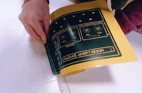

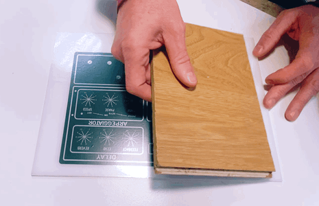

Step 6: Adding the Front Panel to the Opal Acrylic
Now that the circuit has been built (and hopefully works as it should), the next step is to add the front cover design to some acrylic. I have used opal acrylic so you can see the on/off indicator LED inside the panel. You could also use white which I'm sure would still allow the LED to be seen
STEPS:
  1. First thing to do is to print the front panel design onto some clear adhesive. This has a sticky back which allows you to attach it to the acrylic. The front panel design can be found as an attachment in this step.
  2. It can be a little tricky adding a label this big. It's easy to get wrinkles and air pockets. You need to take your time and use something flat like a ruler to drag around the adhesive to ensure these are kept at a minimum.
  3. Once the front panel is on the acrylic, use something flat to remove any air pockets. You want to use something which has a soft edge so you don't scratch the ink on the panel. I used a piece of floating floor which has some foam on the back.
  4. To protect the front panel, you need to spray it a few times with some clear acrylic paint. I use a matt one as it give a nice, clean finish. Let it dry between coats

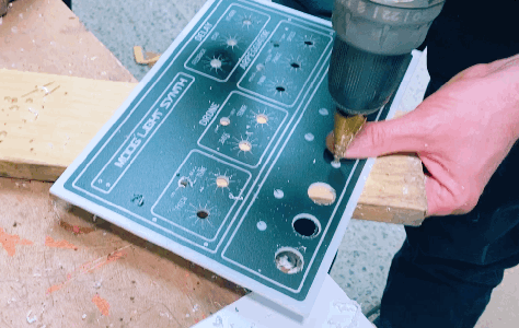

Step 7: Drilling and Test Fitting the Front Panel
I use a step drill piece to drill the holes as it works very well and allows you to easily create the correct sized holes for the components.
STEPS:
  1. Before you start to drill, use a punch to help ensure the holes are centred.
  2. Place the panel onto some wood and carefully drill each of the holes. I use a piece of wood with a large hole drilled into it already so the stepped drill piece doesn't have any resistance when being drilled into the acrylic.
  3. Once all the holes have been drilled out, you might find that they need to be cleaned up a little. Use an exacto knife to do this and run it around the edges of each hole.
  4. Give it another spray with some clear acrylic and leave to dry
  5. Test fit the PCB to make sure it fits correctly. If there any any sections that seem a little tight, you might need to make that hole in the panel a little bigger

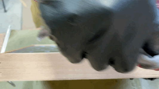

Step 8: Making the Case
Making the case is pretty straight forward. I use skirting board hard wood to do this and it works well.
STEPS:
  1. The first thing to do is to secure the wood to a flat surface and make a groove along the top section. This is so you can secure the front panel to the case. If you don't have the tools to do this (router - in my case a dremel and a routing bit - 3mm), then you could just skip this and either just screw or stick the front panel to the case.
  2. Router out the wood and then cut the wood to size. To do this easily, place the panel into the groove cut and mark where you need to cut.
  3. Once all the pieces have been cut, place them onto the front panel and make sure everything fits correctly.
  4. If it does (don't worry about overhang, we'll fix this in the next step) then you can either glue or nail the case together. I use a small nail gun (brader) to do this mainly because I'm too impatient to wait for the glue to dry!

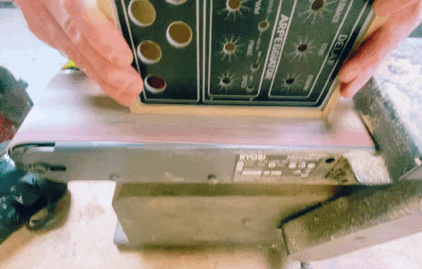

Step 9: Making the Base & Sanding & Painting the Case
Time to now make the base which is just some thin ply wood. You make the base now so you can sand everything together and make sure it fits perfectly to the case
STEPS:
  1. Cut a piece of thin ply wood to size and secure it to the base via a couple of screws. You don't have to add all 4 screws if you don't want to yet, just a couple to hold it into place.
  2. Use a belt sander (if you have one) or just hand sand it until everything is even and smooth
  3. To protect the wood, I used some clear polyurethane and added a couple of coats to the wood. Make sure you take your time around the top section and don't get any onto the panel.
