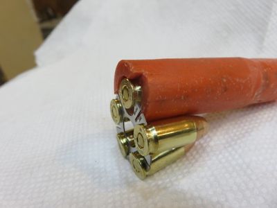

I made two tools one was made from a piece of plastic rod, and the other was made from a piece of aluminum tubing salvaged from a damaged easel tripod.
The plastic model is a little too big, 5/8 diameter would be better than the 3/4 inch that was used. With the plastic model I load every other round to reduce interference. It works well for demooning.
The aluminum model works very well and slips in you pocket like a pen. (might see if I can find a slip on pocket pen clip)
Step 1: Making the Plastic Model
The rod was drilled 7/16 (could be 1/32 small , but did not have that size bit) 3/4" depth one end and 1 1/8" depth on the other end.
On the end that is drill 1 1/8" a notch is cut 1/8" deep. (notch is not centered it is about 1/3 of the diameter)
A flush trim hand saw was used to cut the notch.

To load a moon clip insert a round in the loader end, then holding the clip in one hand present the extractor groove to the clip and press into place. (using your hand and wrist instead of just your finger and thumb)
Repeat five time until clip is full. (as mentioned previously with the larger plastic model load every other round to minimize interference)
To unload (demoon) using the notched end, insert casing into tool, using the notch against the clip, roll the tool slightly and cam the casing out of the clip.
