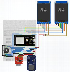

Step 1: Wiring
Wiring is straight forward as shown above, detailed pin assignments are also shown in the sketch. Driving two displays using the same library can be done by using different CS (Chip Select) pins independent from the library. The library in use is 'TFT_eSPI' which is an universal approach for many different display modules, but it's getting finicky if you want to drive two different types of displays.
The two displays in use are wired in parallel, only the CS pins are separated. In the sketch, I select the correct display by writing a '0' (CS is low active) to the matching pin.Using a larger screen avoids these added hoops, but you would also need to adjust the position references for graphics shown on the secondary display.
It should only take a couple of minutes to put everything together on a breadboard. I created a little case for those who are interested.
Here is the link to tinkercad if one likes to remix it:
https://www.tinkercad.com/things/01KVY4onpfN-moon-phase-observer-view-box
