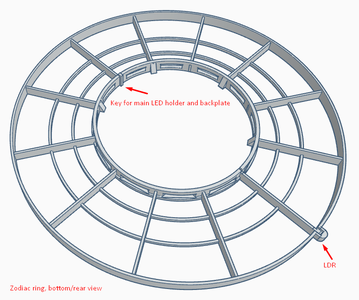

Color choice for the ring holding the acrylic zodiac signs is your choice, I used a silk-silver filament for a metal-like touch. This part is being printed upside down from how it is shown in the Tinkercad model. This reduces the need for support drastically and results in a nicer finish for the visible parts.

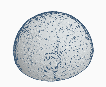

I used silk-white for the moon dome, adding a nice shine to the illuminated parts. I think plain white works, but makes the appearance a bit dull if you used a silky filament for the zodiac ring. The model for the moon is not hollow, so it needs some changes in the printer settings. I tried just spiralizing the print, but that caused lots of gaps in the top part. The best setting I found is as follows:

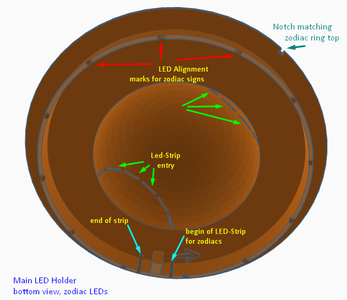

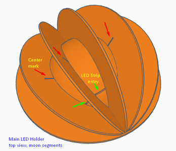

Step 2: Placing LED Strips and Wiring
Placing the LED-Strip on the main holder requires six strips with three LEDs each (six moon compartments) and one strip with 12 LEDs for the zodiacs. (Total of 30). These will be wired as a single strip, moon segments first from right to left when viewing from the side with the dividers. (top-view image) I added a marker in the center of the dividers to make placing the strips easier. Make sure you place these in a zig-zag pattern starting (D-in) at the bottom right (bottom view image showing the notch pointing up). The ends of each strip are tucked into the slits at the upper and lower end of each compartment. The ends can be bent and fixed on the inside, but will possibly detach again as the remaining length of the strip is barely enough to keep it attached. No problem if these detach later as there is no danger of any shortcuts, we got plenty room. Starting with 'D-in' at the bottom right (top-view, divider side) will place the 'D-out' of the moon segments on the bottom left, close to the begin of the 12 LEDs for the zodiacs. If you mixed this up, no biggie, the only thing changing is that the distance between the moon segments end and the begin for the zodiacs is longer. No need to rework everything.
Attach the LEDs for the zodiacs starting with 'D-in' as outlined in the 'bottom view' image in direction as shown by the arrow. Align the LEDS with the V-shaped grooves. If they are a little off, no problem, but deviating too much will impair even illumination of the zodiacs. I think the images above are showing this in great detail.
Wiring is pretty straight forward. All intermediate 'D-out' will be connected to the next 'D-in'. GND and +5V can be connected as you like and do not need to follow the exact sequence. I simply bridged all GND connections on one side of the strips, same for the +5V tabs. To fix the magnet wire in place, one can simply push these into the plastic using the soldering iron tip where needed.
There is also one of the 100uF capacitors, about in the middle of the entire string, right at the beginning of the zodiac LEDs. The images should show all important details.

Step 6: Moon Dome and Zodiac Segments
The moon dome will simply be glued into place. When attaching the LED-holder to the zodiac ring, you may have noticed, that the LED-holder is about 1.5 mm above the Zodiac Ring. This makes sure that the moon dome is equally spaced from the LED-Holder dividers. Just add glue around the rim as shown in the image above. Once in place, turn the display upside down to slide in the zodiacs. To make life easier, find something round (a pot, large mug), a bit smaller than the moon diameter to hold the display for you. Some cushion works as well.
Slide in the zodiacs, starting from any segment you want. A good starting point is the LDR at the bottom of the display. Looking at the back-plate, the first zodiac sign counter clockwise from the LDR is Aquarius. Capricorn is its neighbor on the other side of the LDR. Last thing to do is placing the back covers. I prefer the glossy side on top, the rough side facing the acrylic zodiac segment (avoiding a slight mirror effect). Fix all with a dab of glue at the four corners each. Don't use watery superglue, this will run in between the edges and may cause a foggy residue.
