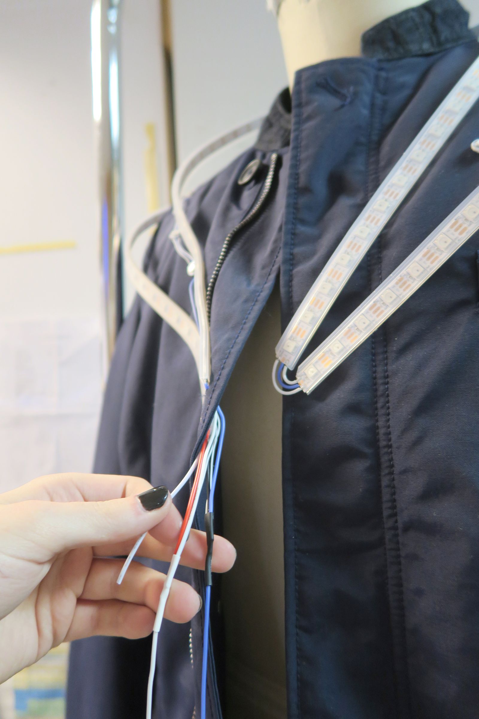

The design for the LED circuit was conceived by Antonia in The Late Show wardrobe department, sketched directly on the jacket with LED strip. To create your own design, put your jacket on a body form or patient model and pin your pixel strip in place (if pinning on a human, be careful not to poke your model). Leave more than you will need in each strip because it's easier to cut pixels off than it is to add them to a strip later.
Check out the circuit diagram for this project. The chain of NeoPixels starts at center front, heading up over the right shoulder and down over the left, then back up over the left and down the right, then back one more time to the left lapel area, where the power and ground lines run to an emblem made of single color LED sequins.

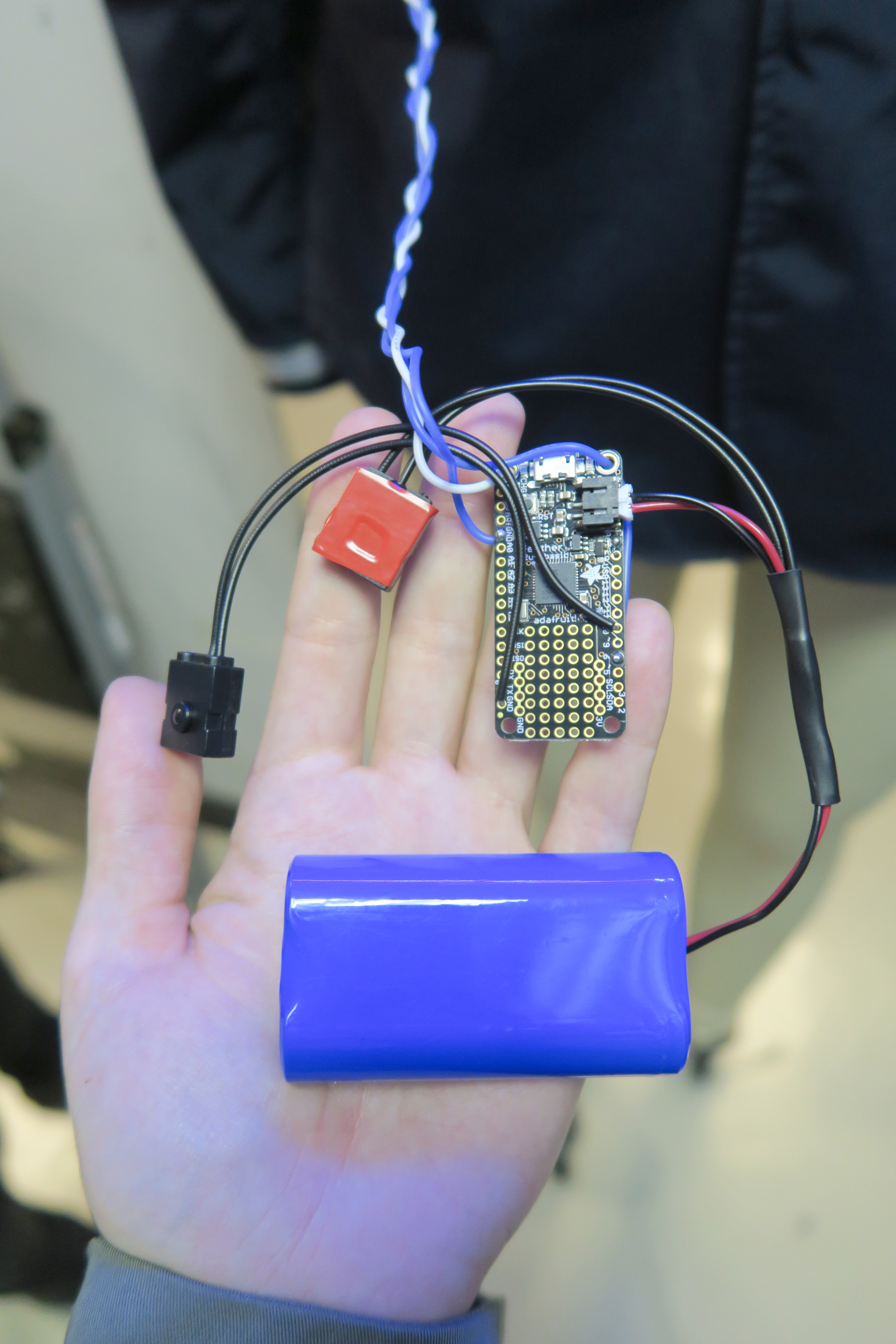

One switch controls battery power, and one triggers an animation effect to occur across the NeoPixels. The circuit is controlled by the Feather 32u4 microcontroller board, which sits in the front right pocket with the switches and battery.

To put together the NeoPixel circuit, use small bits of silicone coated stranded wire, your third hand tool, and soldering iron. Be sure to keep track of the directionality of the NeoPixels while you're building. All the data lines must point towards the end of the strand, as shown in the circuit diagram.
Where the pixel strip reverses direction, solder three wires to connect power, ground, and signal pads. Be sure to tin each pad and each wire end before soldering them together. A stray strand of wire here could cause a major malfunction later, so be careful to twist all strands together and work with good lighting.
For the freeform pixel chain, use a ruler and marking pen to measure and cut pieces of a consistent length. Strip and solder wires connecting power, ground, and signal pads between pixels. This is a pretty time consuming part of the project. Take breaks to stretch and use pliers or tweezers to hold your wires when your fingers get tired.
For even color distribution, it's important to supply supplemental power and ground along a strip of pixels this long. At the right front, power and ground from all three strands join together on their way to the microcontroller, and the joints are protected with heat shrink tubing.

Step 4: Code for Feather 32u4 Microcontroller & Battery Power
Attached is the Arduino sketch for this circuit. It takes switch input from the tactile button on pin 10 and uses it to trigger an animation (or two) to 131 NeoPixels connected to pin 6. To program the Feather 32u4, you will need to install the additional Adafruit boards for your Arduino software.

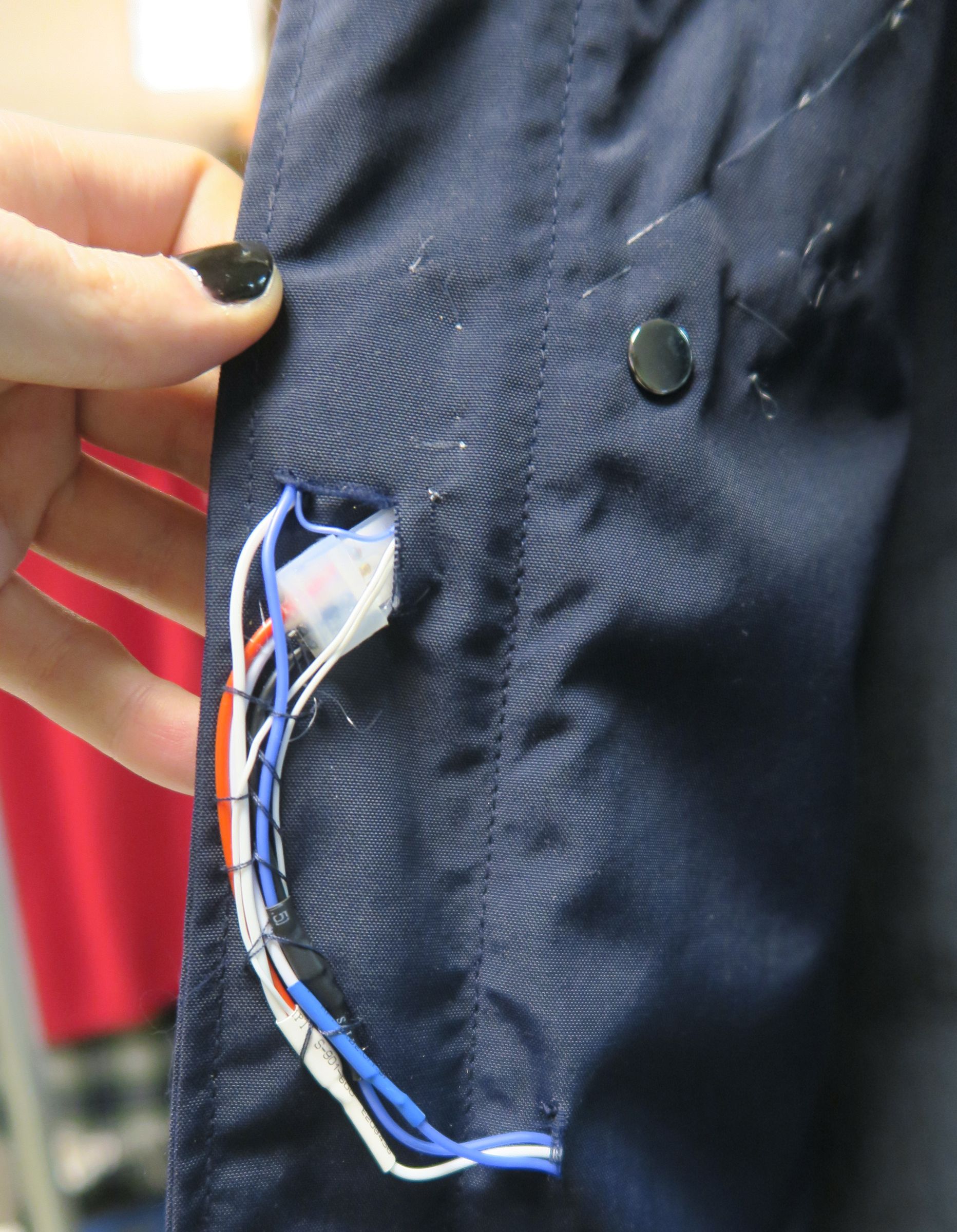

Step 6: Sewing & Wire Management
Most of the pixel strip and wires are held in place with clear quilting thread and a whip stitch. But it's flimsy and annoying, so anywhere that doesn't show is whip stitched in jacket-coordinating cotton/poly thread.
Use a seam ripper to create routing holes for wires as you install different elements. Construction can get a bit awkward when you're taking the bunched up jacket to the soldering station, so be extra careful not to burn or melt anything unintentionally.
It's important to secure any exposed wires so they don't get snagged. In this case it was also important to stop the zipper from extending past a certain point by whipping around the teeth several dozen times.
