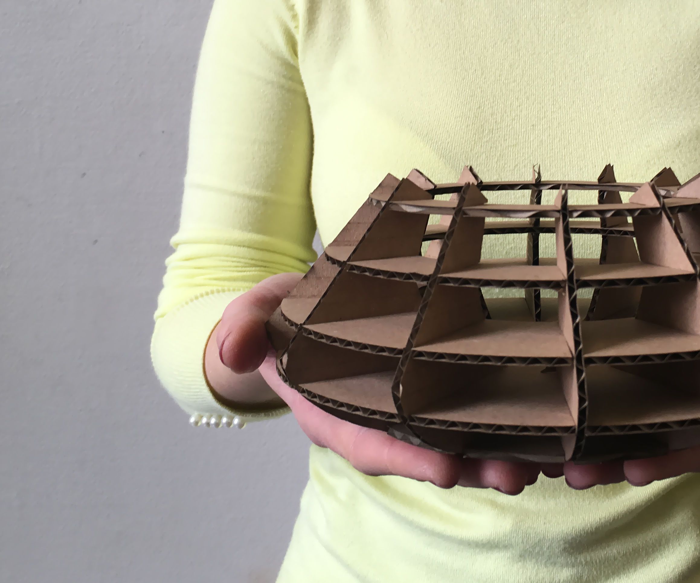

Introduction: Moon Stool
A lightweight stool/bedside table with slightly asymmetrical legs and geometric cuts.
4-part design for assembly, with a lock mechanism, made on a CNC router. Based on a model developed by Twistab.
