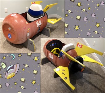

Introduction: MoonPi, the Rain Barrel Kids Play Rocket
Just after Halloween, my 3 year old daughter came to me and announced she wanted to be an astronaut and fly to the moon! She kept talking about flying a rocket to the moon for days on end, so naturally, I started thinking of ways to make her dream come true.
Her rocket is a former rain barrel (former food container technically), with flight controls and a Raspberry Pi2 model B combined with an Adafruit 2.8" touch screen hooked up to push buttons that select different space related video files to play.
I give you, MoonPi, the rain barrel kids play rocket!

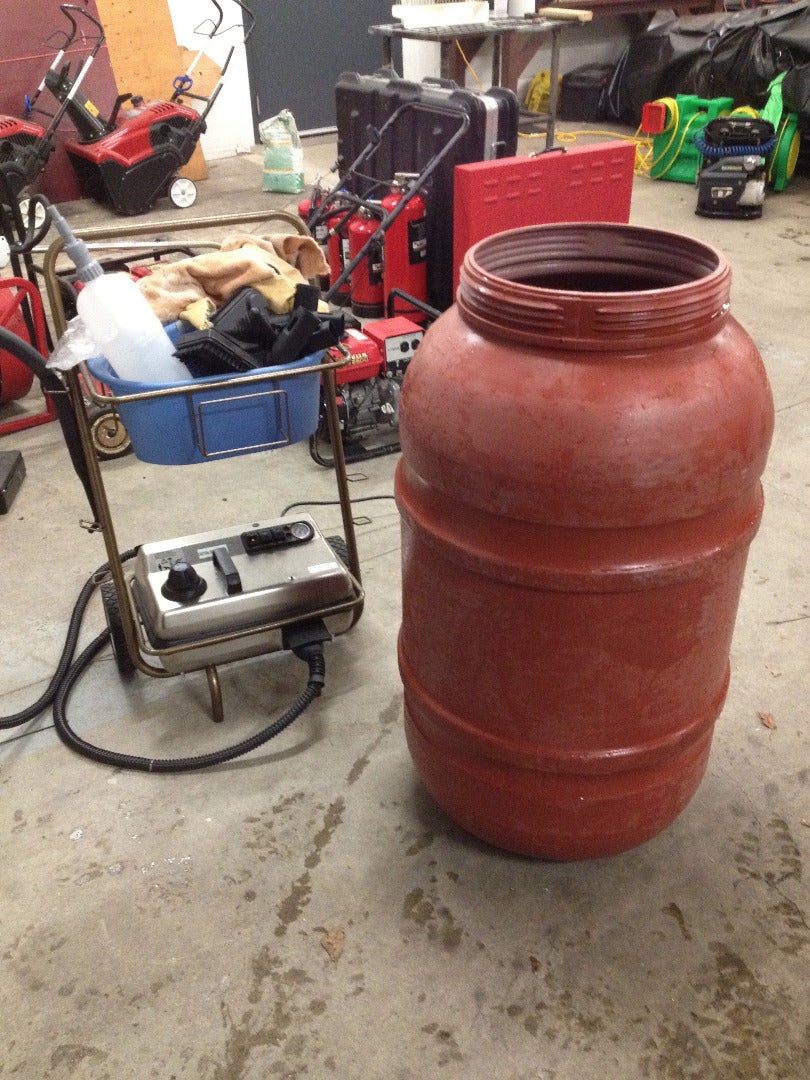

Finding an appropriately sized rain barrel was fairly easy.
There are many farm and garden supply stores in the area and they carry barrels of all different sizes.
One thing that may save you money (thanks to the sales woman at the store I went to), I had no use for the debris screen and spigot since I was going to be cutting a large hole in my barrel and it will never hold any water. She sold me a barrel that had not had these parts installed yet for a fraction of the price of a fully armed and operational rain barrel.
Cost was about $20 Canadian.
Be sure it includes the solid top cap, we need to mount the rocket engine to it as well make a space to hide the power pack and network connection.
I learned that barrels of this nature are usually former food stuffs shipping containers. This fact became obvious when I opened mine up and got a whiff of pickles. Nice to know they weren't used to store PCB's or worse yet... broccoli! Oh wait...
I used a lot of dish soap and stiff bristle brush to scrub inside and out, then hit it with a commercial steamer, then more soap and brushing to be sure the smell was gone and it was in fact clean since it was going to be inside and played with by kids.
It took an entire day of washing, scrubbing, letting it sit with soap in it, steam, rinse, repeat. But in the end, it was good as new.

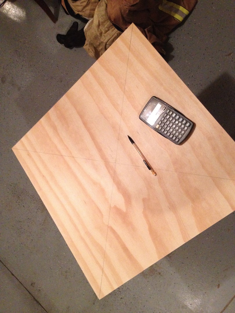

I love Pie, but Pi works better to figure this out...
The barrel's circumference is approx. 69.15"
So, 69.15" ÷ 3.141 = 22"
Now we know the diameter of the two circular bulkheads. Next we need to mark out the cut line on each piece of 2' square plywood.
A neat trick for making a perfect circle on a piece of wood:
- Find the center of the SQUARE piece of wood by using a straightedge and drawing a line from opposite corner to corner.
- Where the lines intersect is the center.
- Since we know the diameter of the circle is 22" we can divide that in half and get the radius of 11".
- Find a scrap piece of thin wood, or stiff cardboard.
- Cut it to 13" or 14" long.
- Drill a pencil sized hole close to one end of this scrap (card)board, in the middle.
- Measure from that hole, in 11" and make another mark in the middle.
- Drill a hole here, sized for a small nail.
- Place a nail through this hole and hammer it slightly (not all the way through) into the exact center of the 2' wood we need to make our circle on.
- You now have a rotary arm that, if a pencil is placed at the outer hole and the arm is rotated around, will etch a perfect 22" circle on your wood.
- This will become the unseen backside of the piece, since it will have a small nail hold in the center (if that matters).

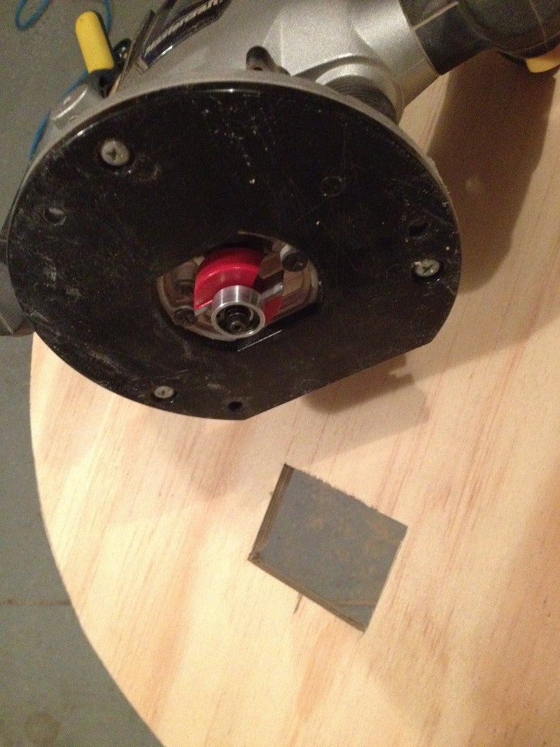

The screen is protected by a piece of custom cut clear acrylic inset to be flush with the surface of the wood using a rabbet bit in a plunge router.
Measure out the screen itself (not he attached circuit board underneath it) and mark the dimensions on the wood wherever you want it to be. Mine is in the upper center of the "console" bulkhead.
Drill some pilot holes and cut out the inside of the screen marks.
I got to purchase a shiny new Freud rabbeting bit with several interchangeable bearing sizes for this project (that's my excuse anyways).
Select the bearing to use depending on the amount of rabbeting you want. I didn't need much since it was just to have somewhere for the acrylic to attach to.
Set the depth of the plunge router to the width of the acrylic sheet you have. That way it will lay flush with the wood once in place.
Remember, the corners of your route will be round, as is the nature of the spinning bit, so you will need to cut and file your acrylic to match.

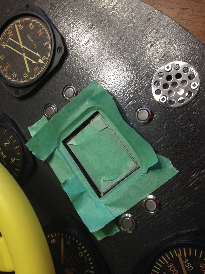

The final part of this step was to fill in the seam around the screen and wood for the display screen.
I used painters tape to create an even space around the screen edge and the rabbeted ledge. I used a tube of black caulking and smoothed it with my finger. Once done, I removed the painters tape, taking all the over spread caulk with it.
Nice clean lines, and no unsightly seam between the screen edge and the wood.
Wait for the caulk to cure before securing your cut acrylic to the rabbet.

The big reveal was Christmas morning, 2015...
This is what building your own toy projects is all about!
The huge smiles and hours of adventure play the MoonPi Rocket has received can't be beat.
Just so long as daddy doesn't have to wear a red shirt and go on a landing party mission...
Thanks for reading!
