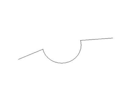

Pictured below is the profile of the gullet between two teeth on a typical cog.

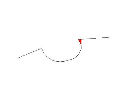

Step 1: The Hook
Over time and use, a hook wears into the gullet profile as shown by the red color. This keeps the chain from sliding out of the gullet smoothly on every tooth during use. This hook does not need to be very pronounced for it to affect performance.

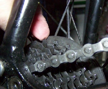

Step 2: Check for Hooking Wear
To check for the presence of hooks on your cog teeth, slide your fingernail from low in the gullet along the working edge of a cog tooth and see if your finger slides effortlessly off of the tooth or if you feel it catch a little on a hooked indentation near the top of the tooth.

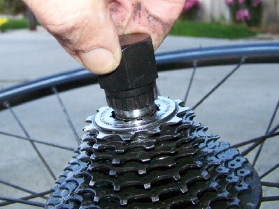

Step 4: Cassette Removal
As you likely know, you need a special cassette removal tool to remove the locking ring. Once it is off, the cassette and its cogs slide off of the end of the spline. Cassette removal tools are specific to the maker of your cassette. A bike from Wal-Mart does not use the same removal tool as a bike with Shimano parts, etc. Check the web site for Park Tool.
