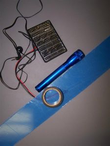

Step 1: Stuff You Need
1. Computer with a microphone input
2. small flashlight
3. Strip of scrap Plexiglas (I get mine free from the local hardware store)
4. Electrical tape
5. An audio recording program. I recommend Audacity. It's free and open source. http://audacity.sourceforge.net/
6. Home made photo gate - (see one of my previous Instructables)

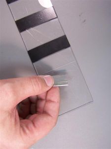

Step 2: Make the Picket Fence
Peel off the protective plastic and start putting on the electrical tape. You're shooting for a regular spacing. Typical picket fences have a 5 cm spacing, so that's what I typically use. You could get higher resolution data by decreasing your spacing. The more precise you are here the better your final data will be.
Note: When measuring be sure to measure from the start of one band to the start of the next!!! Do not measure the space between the bands.
How long you make your fence depends on you. The one I bought from Vernier is about 30 cm long (1 ft). I typically make them longer. The box I store them in will accommodates fences that are 60 cm easily.
When you've reached the desired length just score the plexi with a knife or razor. The plexiglas will break easily at this point. I just use the edge of a table and snap off the excess.

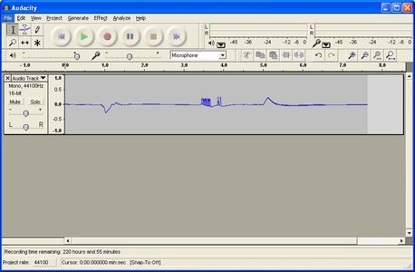

Step 3: Collect Your Data
1. Load up Audacity and plug in the DIY solar probe.
2. Set up the Solar cell and point the flashlight at it.
3. Hit record in Audacity.
4. Drop the Picket Fence (length wise) in between the solarcell and the light
5. Stop recording

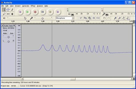

6. Click and drag over the series of peaks representing the drop and then click "Zoom to Fit"
5. Stop recording

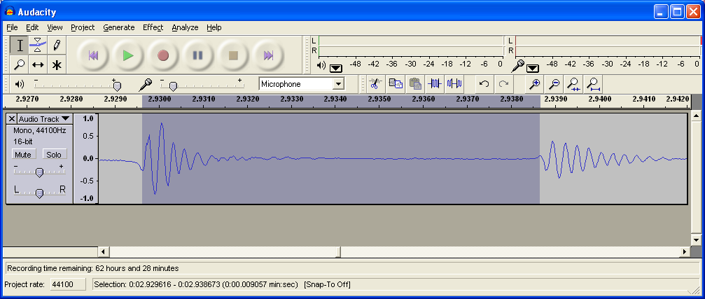

Step 4: Record Your Data
Each peak represents one band. Simply record the time each band happened. The easiest way to get precise numbers is to click on each peak. Audacity tells you where your cursor is in the bottom of your window.

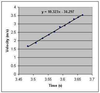

7. Graph Time vs. Instantaneous Velocity (Column A vs. Column C). Chose X-Y Scatter or X-Y Graph, NOT Line Graph.
8. Find the Slope of your line (add trend line).
The slope of a velocity time graph is acceleration. Here we see a value of 10.323 m/s/s. The true value is 9.8 m/s/s. That's just a hair over a 5% error. I can live with that.
I've always assumed that most of the error in this experiment comes from a sloppy picket fence or sloppy point selection in Audacity. One of my colleagues points out another potential source of error is a poor drop (he thinks this is the most significant source of error). If the picket fence is not precisely true when you drop it then the band spacing will be less then 5 cm when it passes the photo gate.

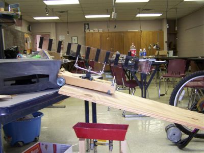

3. You could do The Gallileo Lab. Mount the fence on a cart and run it down a ramp. Vary the angle and find the relationship. Then you make them use vectors and free body diagrams to explain it.
