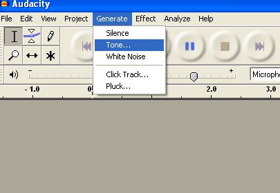

Now that we have our data we can try to reproduce the sound. This is where you'll need Audacity. Once you've opened Audacity just go to the "Generate" menu and select "Tone".
A window will pop up. Keep Waveform as Sine and set frequency to the first frequency on your list. You'll also need to change amplitude. If you leave it at 1.0 then when you add the other frequencies you'll end up with a very distorted sound. I've found 0.3 is a good level for the loudest frequency.

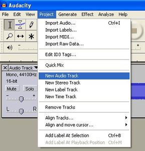

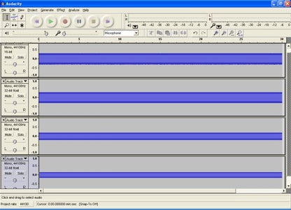

In order to add your other frequencies you must first create a new track. If you don't Audacity will simply append your new tone to the end of the first one. So, for each new tone you add you must first go to the Project menu and select "New Audio Track".
Once you've done that simply "Generate" you new "Tone". Get your second loudest frequency and add it in. Set the amplitude a little lower with each frequency you bring in.
Repeat this process for each frequency you wish to add. Hit play and you'll hear a horrible din. I've attached mine so you can hear it. It doesn't really sound like a beaker at all.

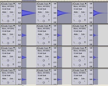

So, what's the problem? Go back to Visual Analyzer. Un-click "Hold" and hit your beaker again. What do you see in the FFT window? The different frequencies drop off very quickly, with only the loudest one (which happens to be the 2nd Harmonic) lasting any appreciable amount of time.

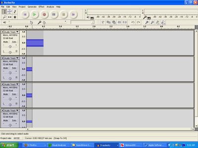

So, lets go back to Audacity and trim our sounds. Simply click and drag over the region you don't want and then hit the delete key. I'll let the first frequency last for around half a second and trim the others down to around a quarter of a second.
Hit play again. I've attached mine again. It still doesn't sound right. There's a simple reason for that. The beaker doesn't stop vibrating instantly. The frequencies being created are damped out, they decay more slowly.

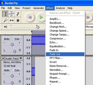

So, so all we need to do is select "Fade Out" from the "Effect" menu. The result is not really very adequate, but if you repeat the fade two more times it ends up being pretty good.
