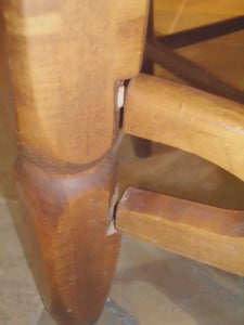

The main things that are wrong with this table are:
  1. The top has split itself into three pieces
  2. The finish on the top is peeling off in places
  3. The leaves can no longer be pulled out from under the table
  4. The cross braces that connect the legs are coming out
  5. The table has a general wobbliness about it

Step 4: The Leg Assembly
The first item for me to fix on the leg assembly was the positioning of the aprons. To do this, I loosened the bolt near the top inside of each leg. This loosened the aprons from the legs and also made it possible to slide the corner brace up and down as needed in the grooves in the aprons. The tabletop sits on supports that are attached to the aprons. With the aprons being too low, the tabletop was sitting directly on top of the leaves, jamming them into the tops of the legs and preventing them from being able to slide.
The next item was the cross braces. Each cross brace was connected to the leg in two places. In the upper connection, there was a dowel and in the lower connection there was a screw. I examined each cross brace attachment to see what needed to be done. All of the dowels were intact, but the glue that had been used to keep it in the leg had failed on each of the dowels. Also, one of the dowels was too long to fit all the way in it's hole. I checked the depth of the hole that it was in with a piece of tape and drill bit and then filed the dowel down until it was the correct length. I then glued it into the hole using Gorilla Glue. I used this glue instead of wood glue for a couple of reasons. The first reason is that I was unsure whether there was still old glue in the hole. Wood glue can only hold wood to wood. It needs to be able to get into the fibers of the wood or it won't hold. In order to ensure there was no glue I would have had to scrape or drill out the hole and that would make the dowel very loose in the hole. Gorilla Glue doesn't have to be wood to wood to get a good bond. It can bond with most anything. The second reason is that the holes were already somewhat loose around the dowels and Gorilla Glue will expand as it sets which will fill in the space and make a nice tight fit.
So, each leg got the dowel glued in and a new screw. The screws on the whole table needed replacing because they were all rusted. I ran into a bit of trouble with the screw in one of the legs. When I went to remove it, it broke off in the hole, so I removed the leg entirely to fix it. On closer inspection I noticed that there was not just my freshly broken screw in the hole, but also an old one from a previous repair job. I was able to get my broken screw out, but decided not to try to get the old one out because it would not be in the way, nor could it be seen with the cross brace in place.
The hole my broken screw was in was pretty chewed up once I got the screw out, so I needed to repair it. I did this by drilling a new, larger hole with a 5/16" drill bit and plugging that hole by gluing in a piece of 5/16" dowel. Once this was dry, I put the leg back in place. I then drilled a new hole for my screw and glued in the dowel. I cinched the legs together with a couple pieces of paracord while everything dried. I used a combination of a tarbuck knot and a honda (or bowstring) knot to pull everything nice and tight until the glue dried.
