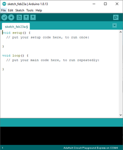

Arduino:
  1. Download and Install the Arduino IDE
  2. Download and Install the drivers for CPX board.
  3. Once Arduino is installed, add the following libraries to your environments (instructions on how to add new libraries on link):
    • Adafruit Circuit Playground (CPX)
    • Adafruit ESP8266
    • Adafruit NeoPixel
    • Blynk
  4. Create a new sketch with File -> New, and then save it.

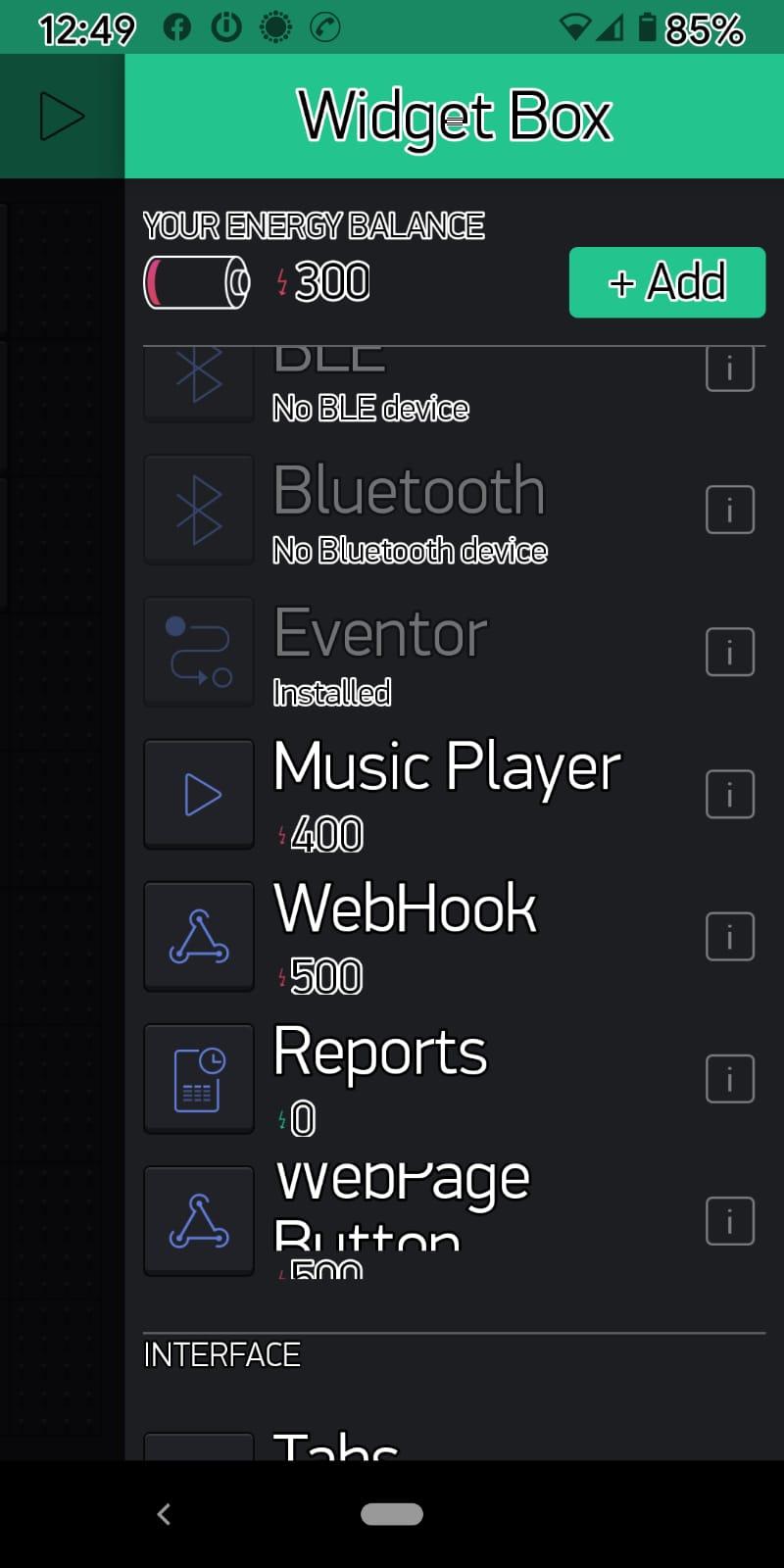

  4. In edit mode, tap anywhere on the screen of the app to open the widgets menu, and add the following to your project (You may need to buy more "Energy" for all widgets):
    • Button
    • Eventor (Only for android at the moment :( )
    • Webhook x 3
    • Menu
    • GPS Trigger

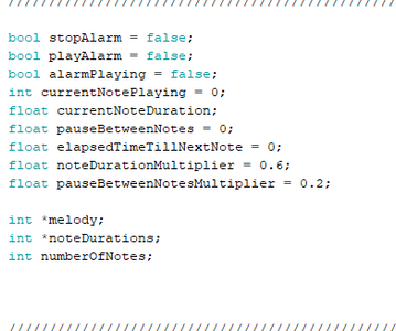

Arduino:
First off, as part of our code you will see in the beginning the next 3 lines:
char auth[] = "[Blynk Auth]";
char ssid[] = "[SSID]";
char pass[] = "[PASS]";
Instead of [Blynk Auth] paste in the authentication you got via email for creating the Blynk project.
In the [SSID] and [PASS] write your home network's SSID and Password.

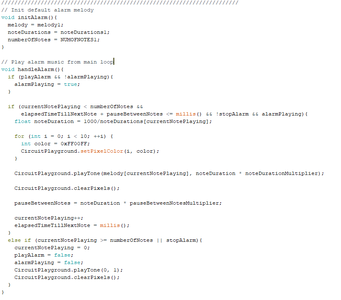

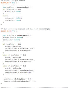

Alarm Related
  • We will receive via V5 from the Eventor a value different from 0, which will cause our CPX board to start playing the current selected melody (when first uploading we will be formatted to the first melody).
  • The melody is played note by note on a timer and won't interfere with background operations of the code.
  • If we receive via V5 the value 0 from the button, the melody will stop playing.
  • Receiving a value from V7 (the menu) will also stop the alarm and set the melody to a different one according to the value.

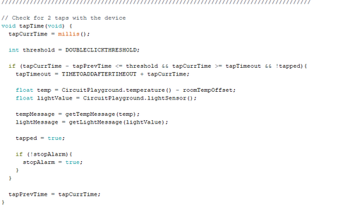

Step 3: Collect Temperatures of the Room and Outside, As Well As the Rooms Light Value, Sending Out Recommendations Accordingly
Each morning before we get out of bed to start our daily routine we should always have a good feel for whatever we should wear and have enough light to help us up.
Using the CPX's accelerometer we will trigger to send information with recommendation for what to dress and if the room is too dark.

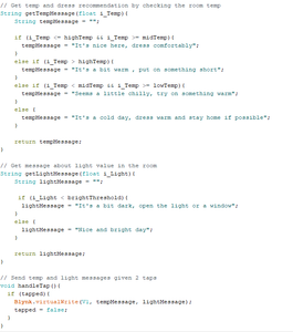

Arduino:
  1. We will set a double tap algorithm that will trigger whenever we tap our CPX on the table twice using it's accelerometer.
  2. Whenever our triggers sets the CPX will collect the light and temperature values in the room, generate helpful messages accordingly and send them out as to pin V1 for the Blynk app to trigger the webhook.

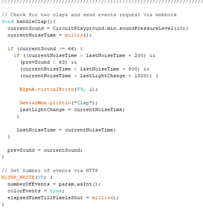

  1. We will set a double clap algorithm that will trigger whenever we clap our hands twice. The CPX will use it's microphone to detect a rise in the volume twice in a given time.
  2. Whenever the triggers sets, we will digital_write to pin V9 a value (doesn't matter) that will trigger via Blynk the webhook.

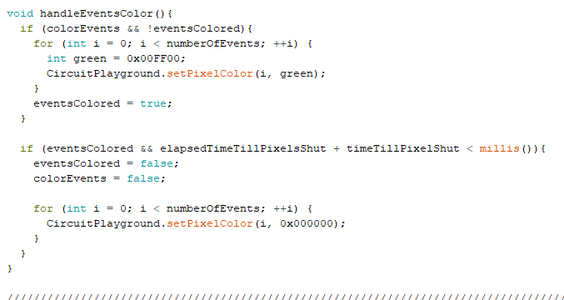

  3. We will receive via pin V8 the HTTP request from step 8 in the Integromat setup and color LEDs on our CPX according to the number of events gathered to signal another way of telling how many event we have today (in case our phone is far away).

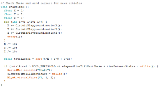

  1. Our code will use an algorithm that will let our CPX detect whenever we shake it using it's accelerometer.
  2. Once our CPX detect it's been shaken it will write to Blynk on pin V1 the value 1 as the parameter checked in the Integromat part in part 3. It will also cause the Blynk to make the webhook POST request, triggering Integromat.

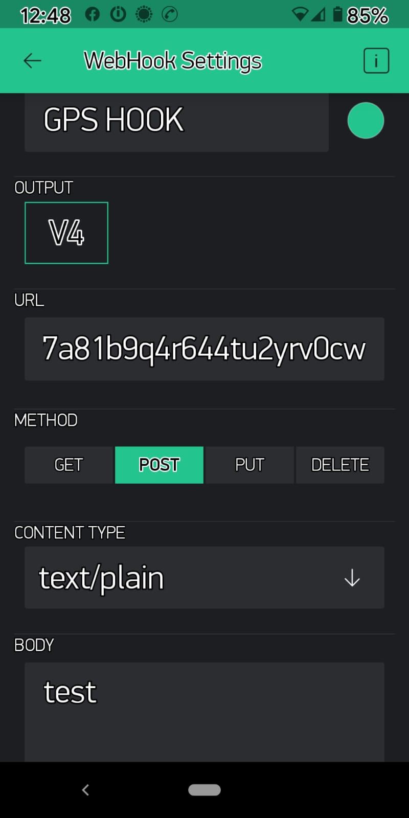

Blynk:
  1. Use the last webhook widget and put the URL of the webhook configured in Integromat and set the pin to V4.
    • As mentioned, not necessary if you reuse the Integromat scenario from step 3.
  2. Configure he GPS trigger widget to be around and close to the location of your house (let Blynk use location services) and with a small radius.
  3. Set the "TRIGGER WHEN" to "ENTER".
  4. Set the output pin to V4.

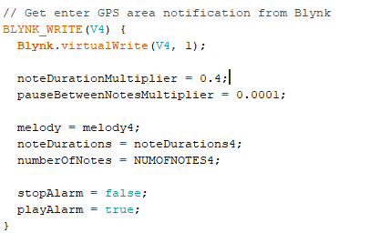

Arduino:
  1. Whenever V4 is triggered, the CPX write to Blynk on the same pin a value of choice to trigger the webhook.
  2. It will also set the melody to 4th one (or another melody from the ones used before) and triggers it to play.
