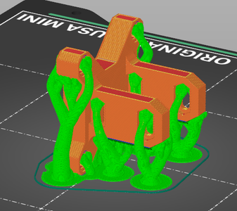

Step 1: 3D Printing the Parts
In order for the Morph3DBot to be stable, functional, and clearly structured, not only the model but also the type of printing is crucial. In this section, you will find recommendations on color selection, print orientation, and the use of support structures.

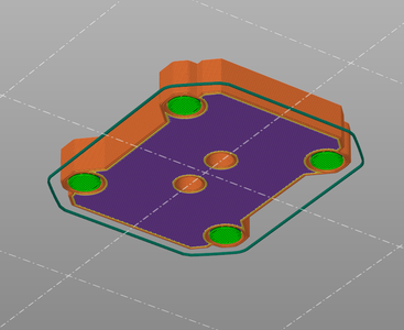

Print alignment
The alignment of the components during printing has a major impact on their stability, accuracy of fit, and load-bearing capacity. To ensure that your Morph3DBot can be assembled stably and requires as little post-processing as possible, please note the following information:
Special alignment for certain components:
  1. Mount_9VBattery_Yellow_v4 and Mount_TwoGearMotors_Red_v4 should be printed so that they are perpendicular (90°) to the planned base plate—i.e., upright on the narrow side. This ensures maximum stability of the mounting structure and optimal fit of the clamp connections.
All other components should be printed so that their largest contact surface is on the print bed.
Support:
Most components have been designed so that they can be printed with little or no support. You should only activate support structures for the holes for the Technic pins. However, there are some exceptions where support structures are useful or necessary. You should print Mount_9VBattery_Yellow_v4 and Mount_TwoGearMotors_Red_v4 with more support. The organic support structure is particularly suitable for this purpose, as it is easier to remove.
Print Settings:
I printed my components using both a Prusa Mini and a Bambu Lab X1C. Here are the settings I used for most parts:
  1. Layer height: 0.2 mm
  2. Infill: 15%, Grid or Gyroid
  3. Perimeters:Standard profiles of the respective printer
  4. Top/Bottom Layers: Standard profiles of the respective printer
  5. Material: PLA
  6. Supports: Only where needed, primarily at Technic pin holes
  7. Print Speed: Standard profiles of the respective printer
Step 2: Remove Support
After printing, you can carefully remove the support structures by hand or with small pliers. Be careful not to damage any surrounding components. Any residue can be easily cleaned with a cutter or sandpaper to ensure a clean fit.
